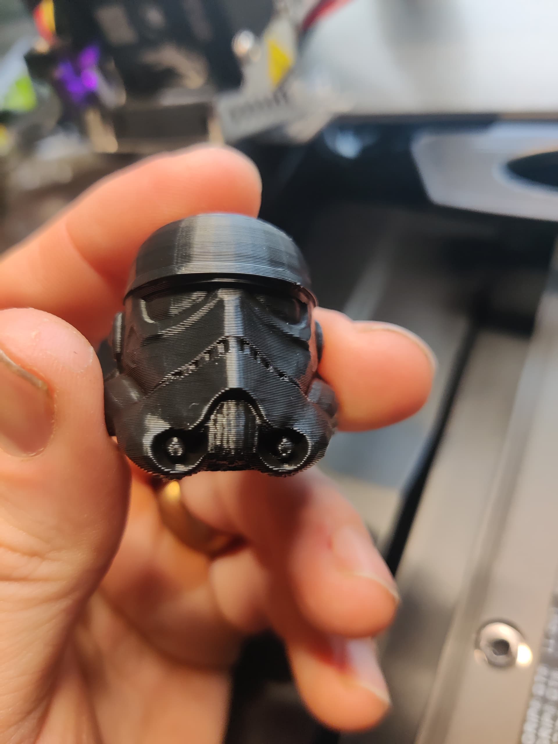

I tried using luban for the SM as yes, that is their preferred software. Eventually I used cura for both just to see if it made a difference. It did not. Interestingly, using the Ender cura defaults with the stock nozzle for the SM produced a pretty decent result. Until it didn’t. Lol. I will upload my latest print with the steel nozzle just for comparison once it is done. It’s using the Amazon filament though. Again, I feel the need to stress again… I love both my machines now. I am going to crack into the other SM functions soon, as the laser engraving is a big reason why I purchased it and the ender is certainly a very capable machine in its own right. In bed now but here is the SM with the default cura settings for an ender. I’ll find a couple of the benchys I printed off with the stock nozzle to compare as well.

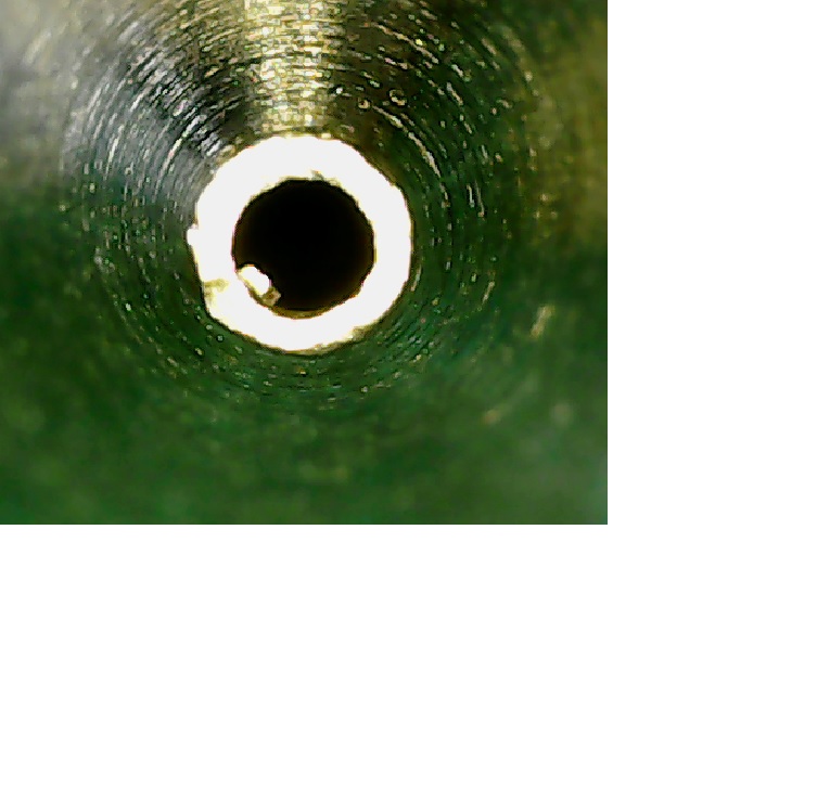

I looked at a cheap nozzle I bought on Amazon with a microscope.
The holes are not very clean and circular, and burrs can be seen. I heard that good quality nozzles have a nice circular shape and good printing quality.

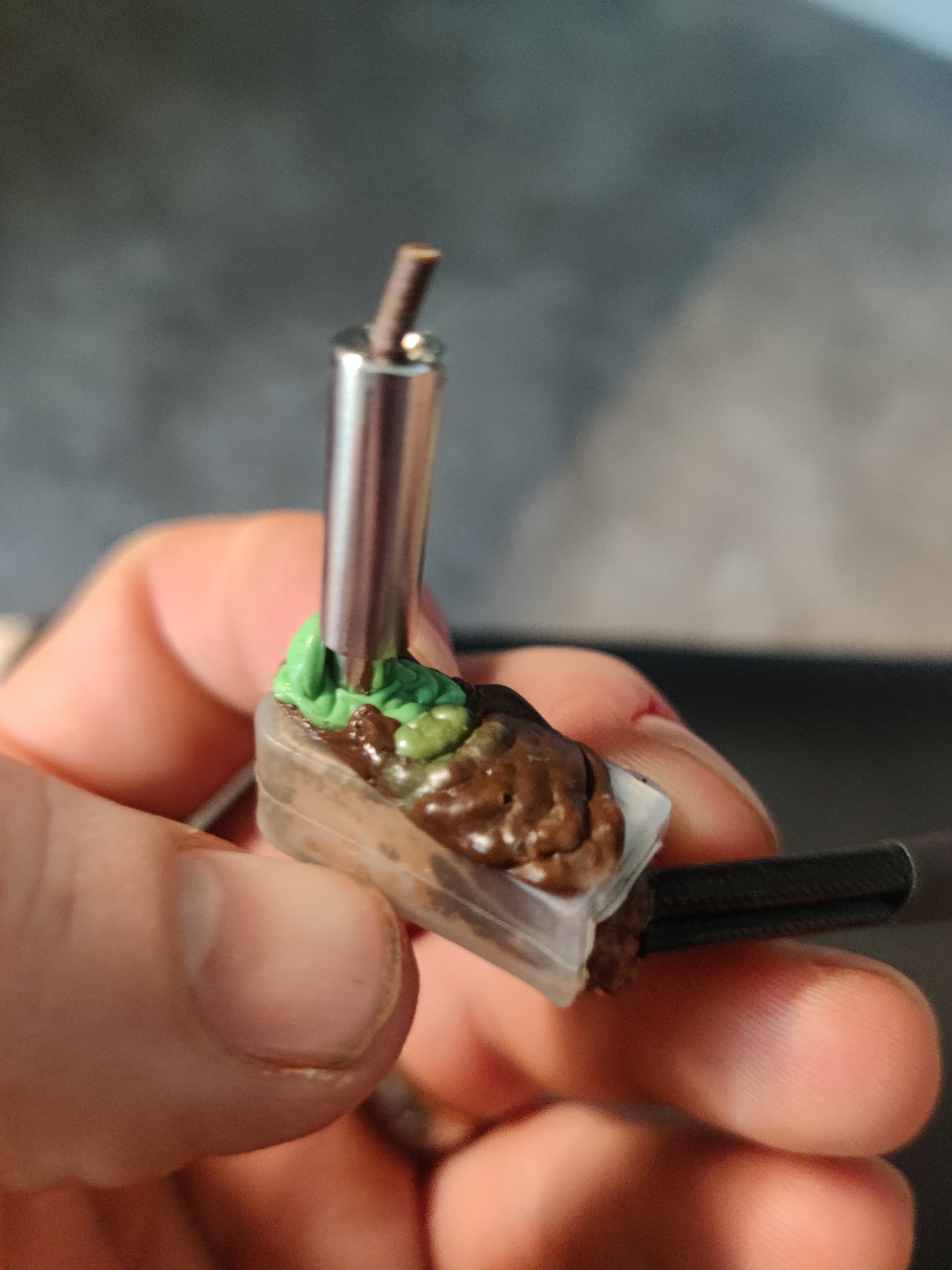

I had an additional issue today that might explain some of my issues as well. I found the hot end was actually leaking molten filament inside the print head. It was not leaking at the nozzle I installed but instead at the throat of the hotend. I’m sure this occurs but it is really questionable given that this is a brand new machine.
I’m sure this contributed to flow issues and many other problems I have been facing with the SM. Fortunately it comes with a spare hot end module and the design means this is very easy to replace but it “feels” bad to have to do this after owning the machine less than a month. Currently running a print that will end up being a Christmas gift and it looks good so far but we will see…

I am beginning to think that I had a bad hot end. Likely slipped by QC because the device did print and was printing in decent quality off and on.
The new hot end is not leaking after running for 4.5 hours and despite some minor quality issues, the current print looks pretty good so far.

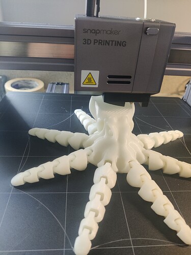

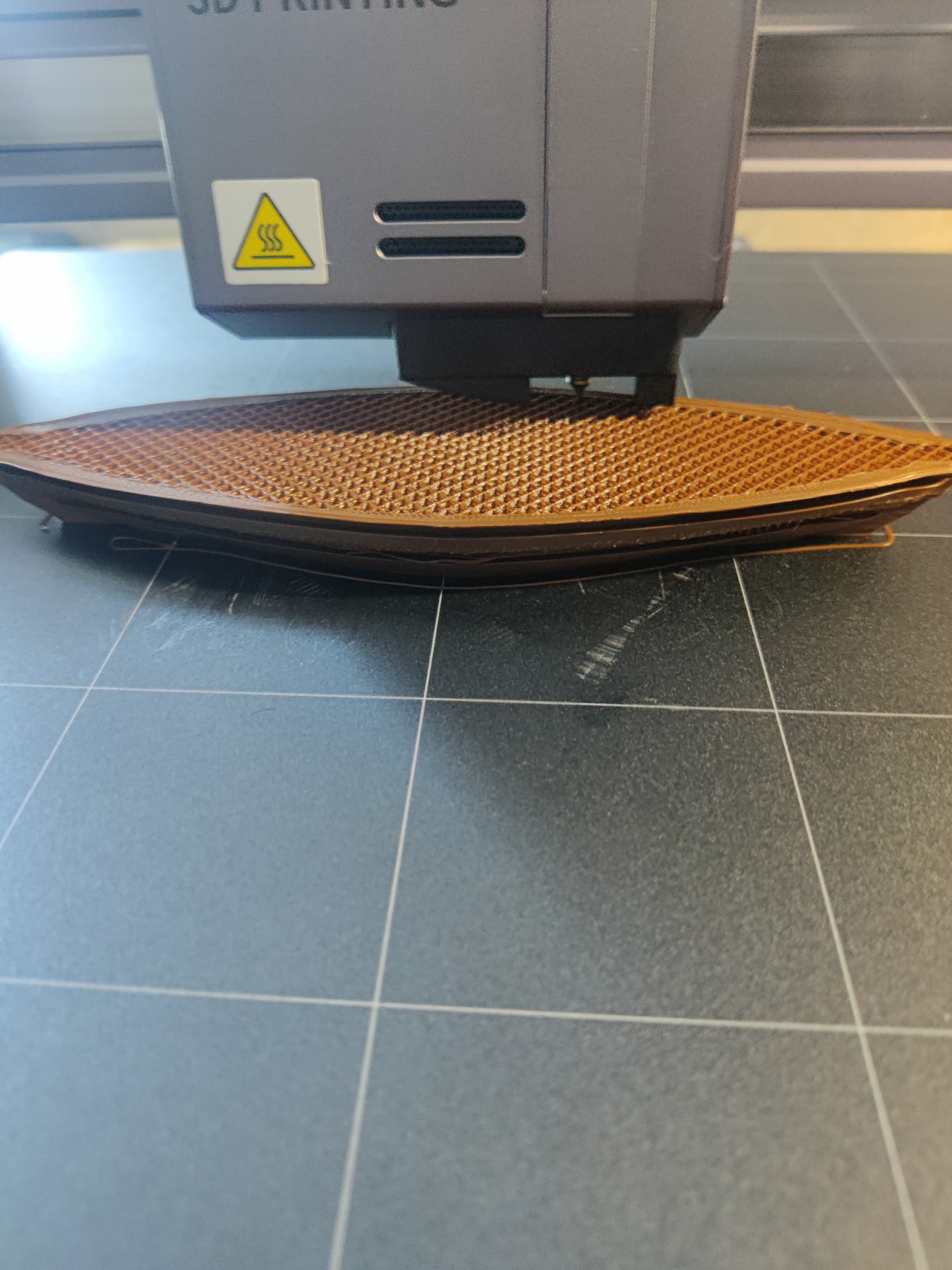

Unrelated, here is the latest print after swapping the hot end and nozzle. I am definitely getting much better results and after 30+ hours of consecutive printing, there are no leaks around the hot end. Very happy with this result. The only issues are caused by the part being printed coming off the bed and creating some roughness. This is a fully articulated squid model that the Ender simply could not print but the SM nailed first try with the added benefit of being able to double the size thanks to the larger print volume.
