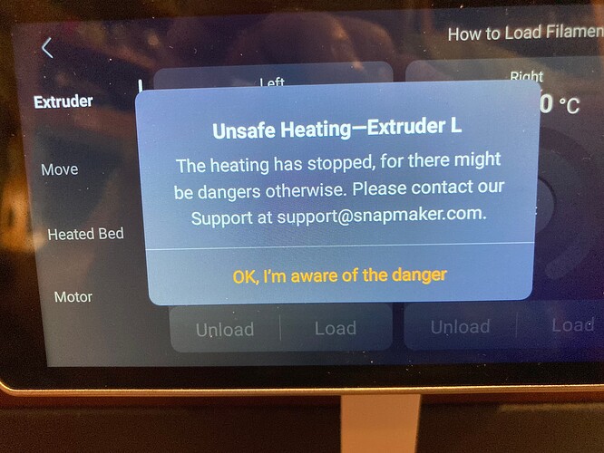

Left extruder temperature control failed completely, middle of a print Failed “OFF” so no damage but generated an
error message. I had turned off filament flow detector as it was extremely erratic, stopping prints when there was no flow problem. Print was going fine but then temperature control went off.
Sent report and log files to Snapmaker support but received lame excuse of understaffed and time off (Chinese New Year?) Anycase, dead in water for now.
Could unstable temperature control be the issue all along? I assumed nozzle temp problems from the beginning. Will see when I hear back from support. I expect I need a new nozzle module??
