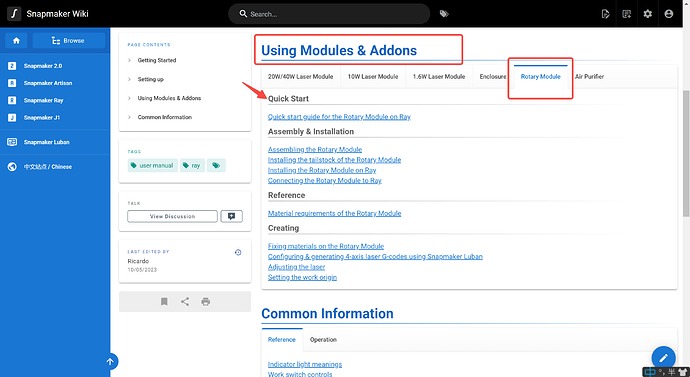

Two Questions concerning the Rotary Module:
  1. In which Port do I Have to Plug it in? Motion? The Wiki is only about the Snapmaker 2.0 etc.
  2. The Cord of the Emergency Buton is very short, around 30cm i guess and i use it in Addon Port. Is there an extension available? Otherwise i cant use it (no Snapmaker Enclosure).

There is a extension cable in the online shop available. :wink: Have fun and feel free to share your laser projects in the showcase category.
It’s considered a motion accessory. I don’t believe you can plug it into the wrong port because the pins are different for each function category.
Thanks a lot, I had overlooked the second cable for the Button. I connected everything as shown in the wiki (device was turned off), but the Button blinks red/green (i think it can not connect). Is there anything i can do beside contacting tech staff (which ist not possible atm, bc. u can’t select ray :slight_smile: )

  1. Did you notice these instructions?
  1. There’s a note for adding the extension cord on the store. However, it’s not obvious.
    Snapmaker Ray 20W & 40W Laser Engraver and Cutter with Air Assist – Snapmaker US
EXTENSION CORD FOR ROTARY MODULE (1.5M):

thanks for the reply. Meanwhile nearly everything is solved (and I got familiar with the wiki :slight_smile: ). I ordered the extension cord with the rotary module but overlooked the cable for the emergency button, which is only blinking red/green.

Sorry for the late answer. The problem was solved , i got a new central unit. Emergencybutton and rotary module are running fine together
