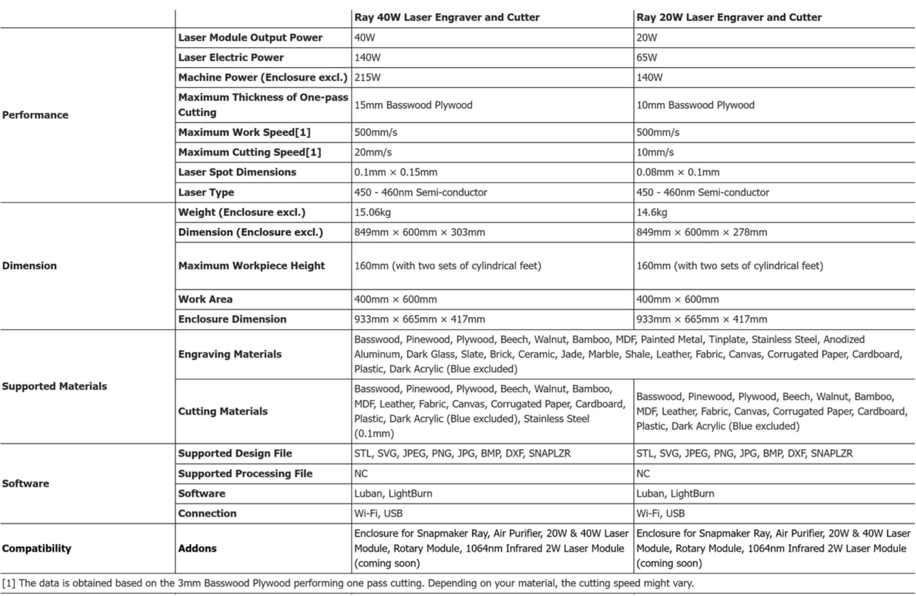

Specs for Ray:

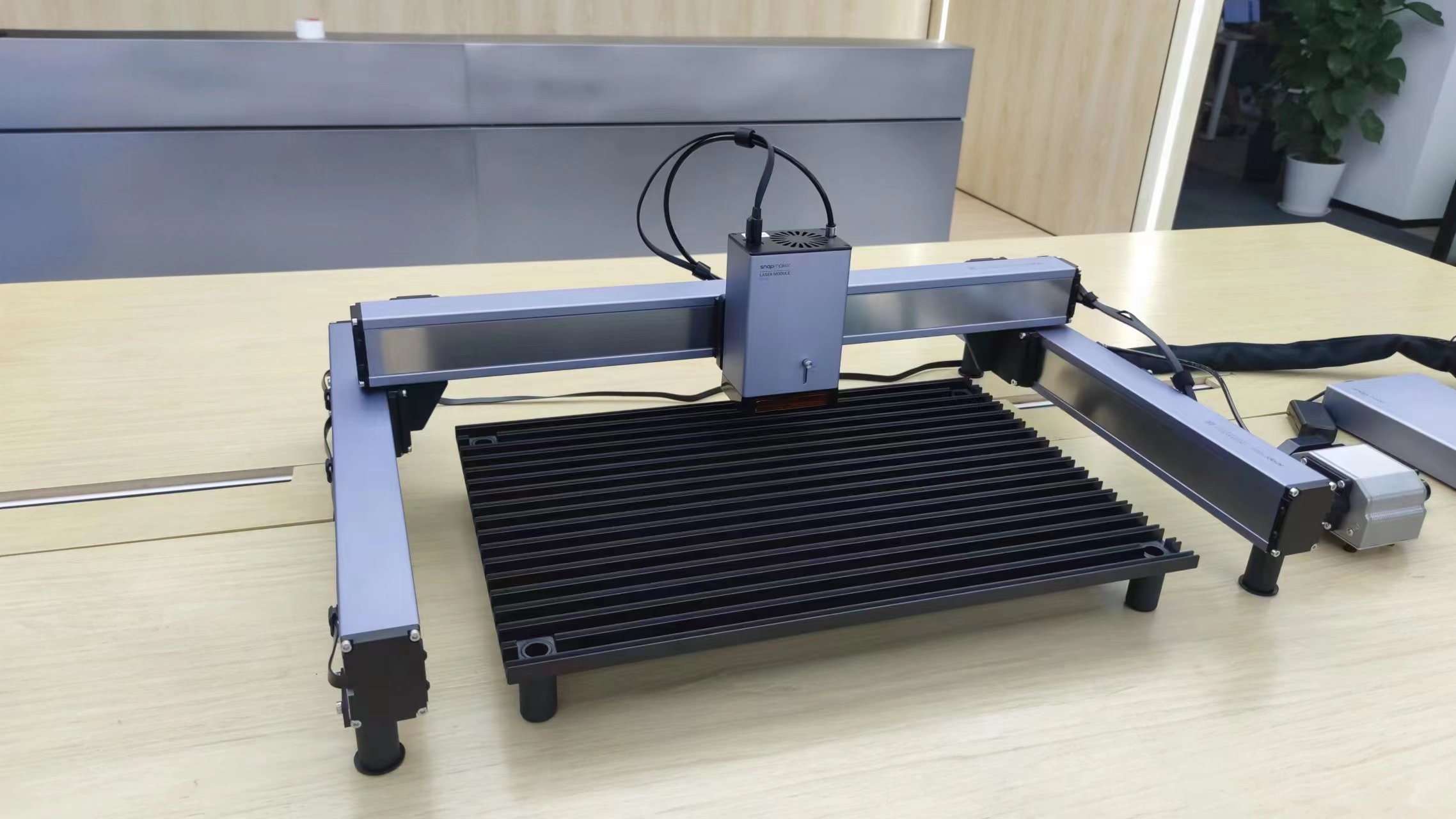

Additional question. I notice in the latest email there is this photo:
I’m assuming that is a Wifi Antenna? Can you confirm we’ll be able to start and control jobs via Luban?

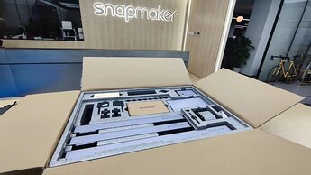

Hey, we just took a quick unboxing video using an iphone. Take a look at what’s inside the Ray box and get a sneak peek of the packing! Hope you will enjoy watching it. Happy weekend!
Yes, that’s for Wi-Fi. And you can control Ray via Luban. :blush:

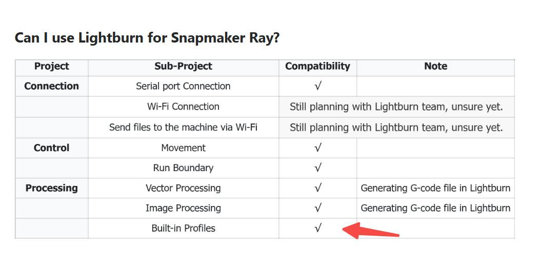

The compatibility between Lightburn and Snapmaker Ray has been updated with one more info. (see below pic)

I got the snapmaker ray working with lightburn, is there way to turn on the Air Purifier from within Ligthburn. It does not start when i am sending a job.
Sending the gcode
M1011 F3 S1
did not work
