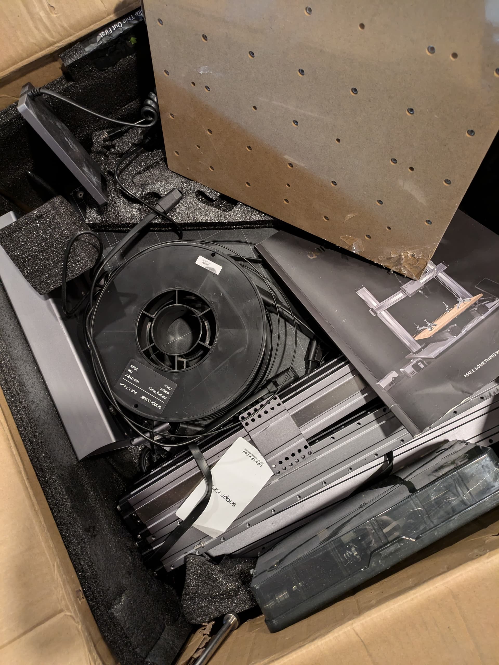

I’m not sure what I’m going to do with this used, bent, beat up box of parts… I assume this is not what you intended to send…? The bag of screws just taped to the side was a nice touch.
Apparently they put it together (and ripped most of the rubber covers off the controller)
All the way up to loading the filament, the filament was open and trimmed to a 45, but never loaded into the hotend (nozzle is clean) this poor machine.

I did a quick assessment of parts and it seems the only things missing are both goggles (CNC and Laser), the M4*10 cap screws for the Laser/CNC platform (the recessed were there already in the heatbed), steel strip tool (if it’s even included anymore), the power cable (PSU to wall), and… the 2.5 hex for the screwdriver… the main one. :frowning: The bag of screws taped to the side of the box is the screws and wingnuts for the CNC clamps.
Otherwise it seems the rest is there, including the snipped end of filament where it was angled.
I may have overlooked something, if I encounter anything else missing I’ll update here as I go on my journey.
I DID identify WHY it was rage-quit returned though! User error/stupidity. :upside_down_face:
That is an 8mm lead on Y. You can see some nice dings on it as well.
And a 20mm on Z (controller and wire guide mounted to it).
So they didn’t pay attention to the lead pitch on the linear modules, and when it didn’t move (or maybe it tried and errored out/grinded), they blamed Snapmaker, rage quit, carelessly chucked it into the box, and sent it back.

It gets worse. :frowning: There isn’t a part that doesn’t have some form of scarring. I guess being shipped around thousands of miles loosely isn’t kind to anything really. One of the steel strips had been shoved into the rail, one actually dinged up the strip, and somehow cracked the baseplate!
How do you crack the baseplate under a mounted rail.
I’ve got a 20mm stroke rail for an A350T if you need, but I don’t have a base plate. I could probably machine one up really fast, but I don’t think I could guarantee it would have the correct z-offset. Let me know if you need the rail.
I don’t think this is critical on the baseplate. I checked the actual layout and it seems to somehow still be flat. I’ll see what I can do first. :slight_smile: I have a bit of experience fixing machinery.
