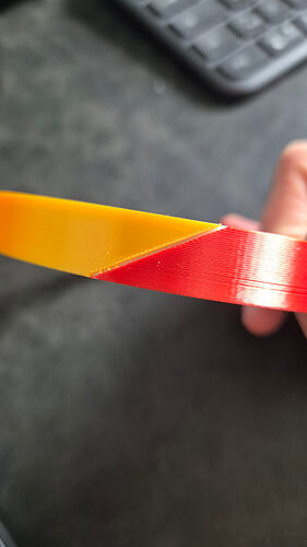

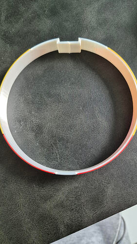

Hello, I’m having an issue with a cylindrical print that has a wall thickness of 1.6mm. On the left side, the color transitions are not clean and not properly bonded. On the right side, however, they look good. (The printed object is symmetrical).
  • It can’t be the filament
The poor quality area occurs during the color change when the toolhead moves away for the next color.
Can someone help me figure out how to eliminate this gap on the left side? It must be related to the print settings concerning the toolhead’s direction of travel or its movement away to the park position.

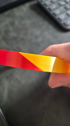

On the other hand, the color transition looks good.
There are issues with the color transitions on the left side, while they are fine on the right side.
