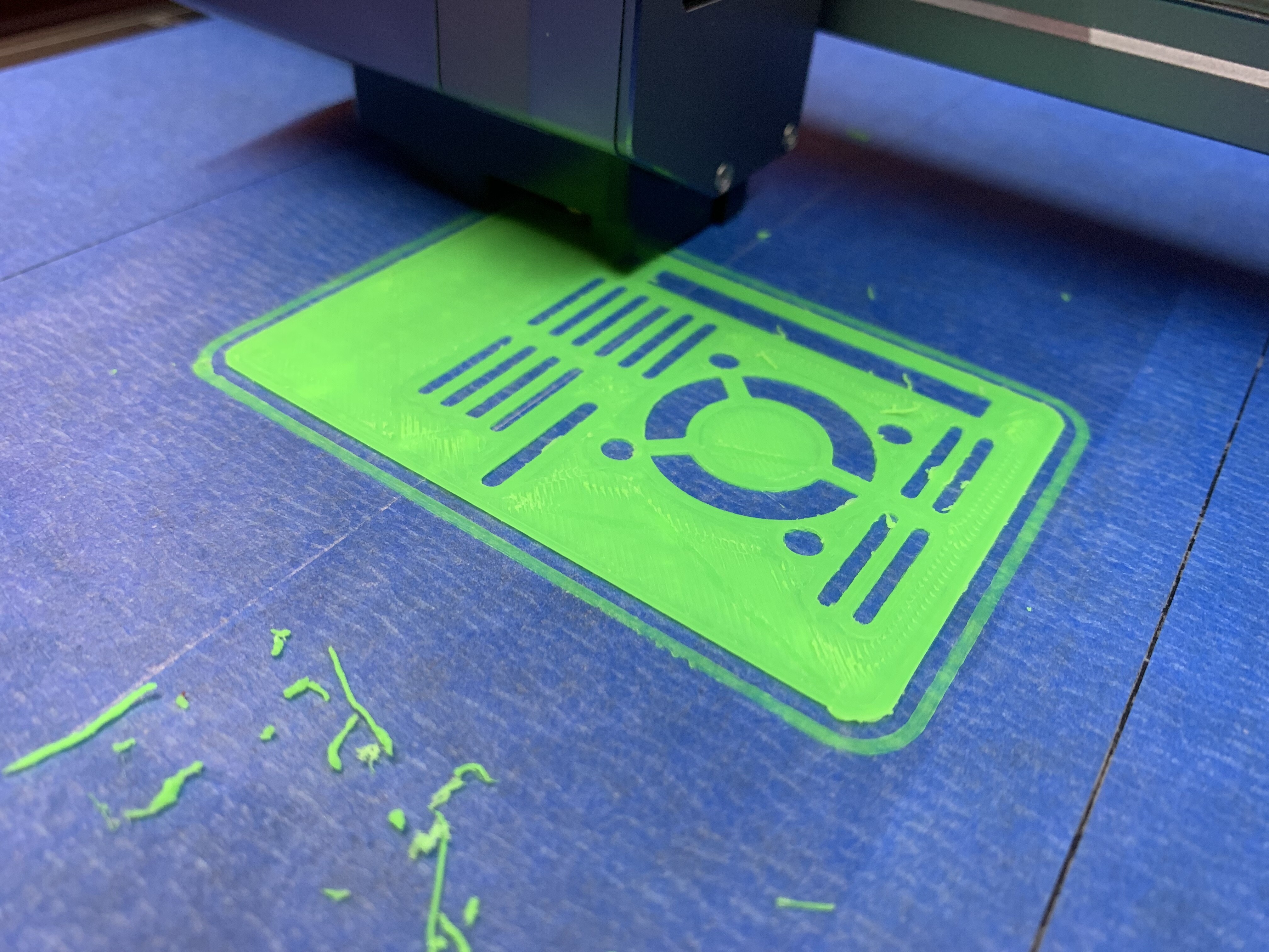

My printer recently started doing a funny little thing with scrapes a very thin layer off the top of the previous layer and it rolls up in a little balls looking a lot like mouse droppings.
I’m calibrated. I’ve calibrate a little bit up. I pause the print and added .05 millimeter to it. No change.
And as one would expect, the nozzle can start picking up these droppings and grow them.
Suggestions?

It was a brand new nozzle. And once I saw the finished result up close I realized what happened.
I had calibrated my extrusion on a different roll of filament and with a nozzle I’d used a couple of times already.
I’d changed filament and at the end of the last print had seen a few droppings.
This print was using a new nozzle. I know now I should have recalibrated the extrusion.
I’ll do that right after I clean this part whilst chanting my new mantra: New nozzle, new calibration.

The problem was that I measured the extrusion rate with a partially clogged nozzle. When it ran, the increased rate gave me an improved flow and I got some nice prints from it.
When I changed the filament to the same brand, different color, no big deal. The old nozzle was still working, but still partially clogged, with an increased filament flow.
But when I changed out the nozzle for a clean, new nozzle, it was sending out a lot of extra filament that became mouse droppings.
So now, when I swap a nozzle - and they’re really torquing them down, now - I know to recalibrate the extrusion rate.

It seems obvious to me that when I was using a partially constricted nozzle, setting the extruder to push more filament through compensated and produced good prints. However, that increased flow going through a clean, new and unconstricted nozzle was pushing too much melt onto the print.
The effect was a bit like putting frosting on top of the first layer of a cake, then laying the second layer of the cake on top. The frosting is squeezed out the sides and that’s exactly what it looks like. I currently have the extrusion multiplier set to over 300, which apparently was ok for the diminished flow of the partially clogged nozzle. I’ll measure again with a completely new nozzle and compare the calculation for the multiplier.

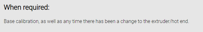

Generally, these questions are answered at the top of each section here: https://teachingtechyt.github.io/calibration.html
For example, for e-steps:
