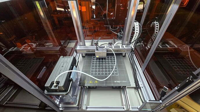

I’ve had my Snapmaker 2.0 A350 for about 4 months now, and I’m now starting to get very fed up with it. For basic prints, it does well. But when I’m printing more “complex” things, such as this multiboard: 8x8 Multiboard Corner Tile - 3D model by Multiboard on Thangs, it consistently fails, and usually never at the same spot (Note: this isn’t the only print it does it with, it’s just one of many examples).
I’ve tweaked the temp settings, extrusion settings, type of filament, etc. I’ve come to realize that it’s the gear in the extruder that eats at the filament when retracting. The gear looks worn, or maybe it’s something else? Anyone else have this issue? I like the Snapmaker and the 3-and-1 feature, but I’m considering giving it up if this is typical for the 3d print function. Any help is appreciated.
What is failing exactly?
Seems like the gear eats at the filament during retracting and extruding when it has to do it quite often.

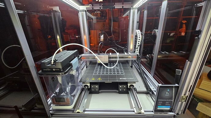

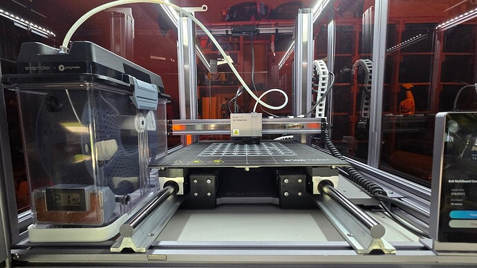

Looking at the pictures, your filament path is far from ideal. Even in PTFE tubing it can be at harsh angles when it’s hard for the filament to slide through. Plus the tension of the filament at the spool
This multiplied by the default retraction speed - gives you problems.
Reduce the retraction speed, waaaaaay down. And fix the PTFE tube so it doesn’t just dangle around in the air.
I’d verify also if the filament is easy to move between spool and the PTFE port on the dryer.
I did this mod for the dry box (Polydryer Mod by mygiguser - Thingiverse), so it moves very well inside… huge difference. Before I did that, I put the snapdryer in the location that was mentioned in the wiki (https://wiki.snapmaker.com/en/general/manual/qsg_for_snapdryer) - Method 1 #2, and had issues. I then did this mod (Universal filamentholder for Snapmaker 2.0 A350 by autocharly4747 - Thingiverse), and had issues with the enclosure so I added this mod (Snapmaker A350 Filament guide by sdj544 - Thingiverse) with no luck. That’s how I got to putting the SnapDryer in the enclosure. I wanted the shortest path for the filament since I was having so many issues.
