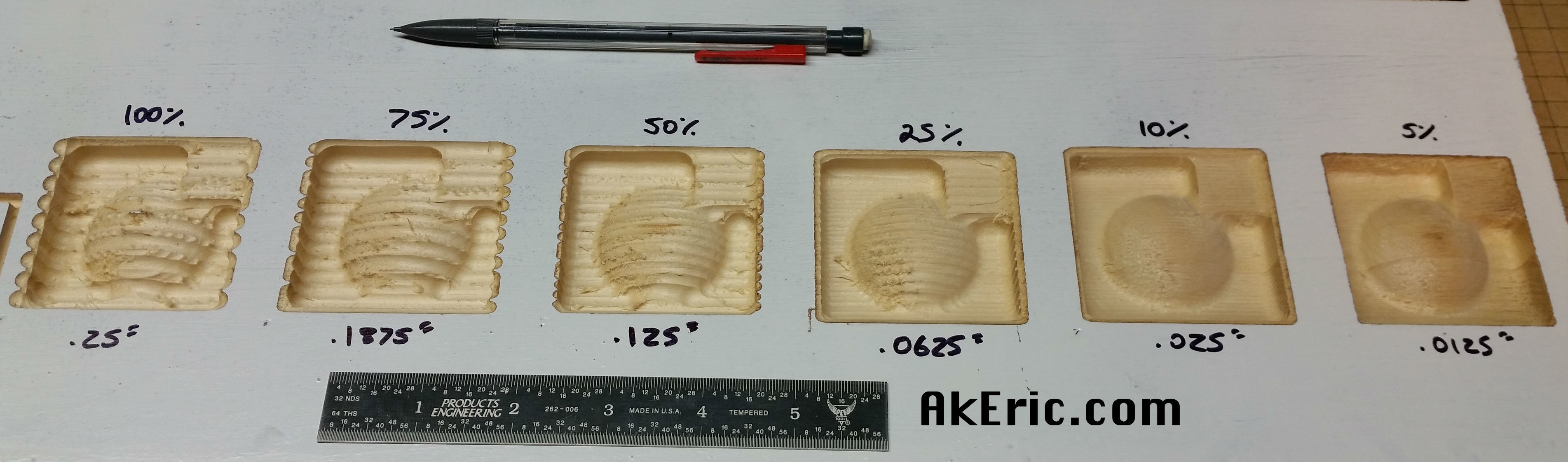

Step over is how much the bit moves over as it goes. It can kind of be relatable to the ‘resolution’ of your cut. The smaller your stepover, the better your finish, but the longer it will take. For roughing with a 3mm bit, a stepover of say 2mm will make it quick, but have scallop lines, but for a final pass with a V bit, your stepover would only be 0.1-0.2mm to make a smoother finish.
It’s particularly important when using a bullnose, tapered ball endmill, or other finishing bit
Example of large to small stepover;
I’m not familiar with the separate from boundry, but I assume it’s likely similar to the machining boundry in Fusion360
Where 'separate from boundary likely would be a silhouette, and connected to boundary would be like the bounding box in the above image. (basically just your engrave vs clearing out the entire square bounding box)
EDIT: Or a better example would be in the stepover example above; Silhouette would JUST cut the dome part, whereas bounding box would cut the entire square AND the dome, flattening out the entire area in the bounding square.
