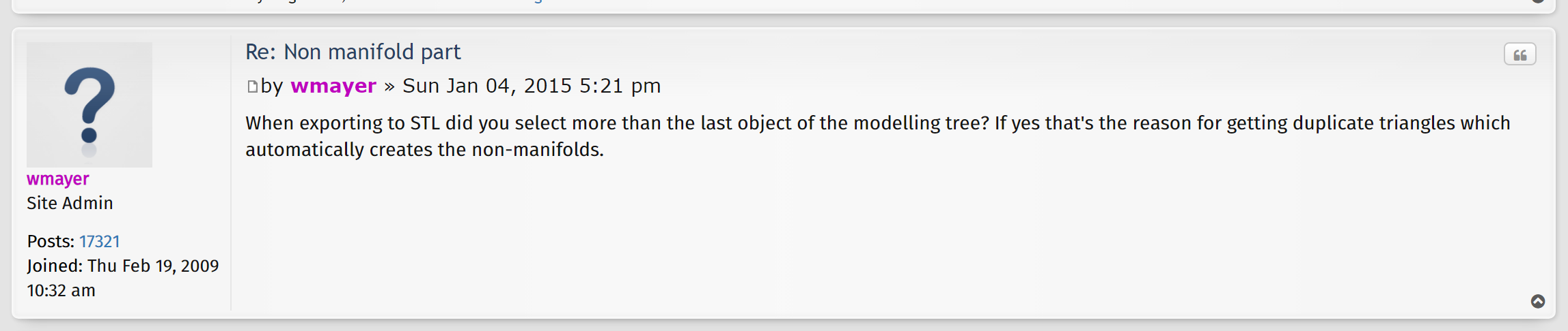

Brent, thank you for the response. I’m a newbie, and this is the first I’ve heard the term manifold. This prompted me to do some research and now I know a bit more! I found a post on the FreeCAD forum that matches what I did: selected all objects in the body rather than just the last one.
Thanks for helping me get educated. It is interesting, though, that Cura did not have a problem with the stl file whereas Luban did.
