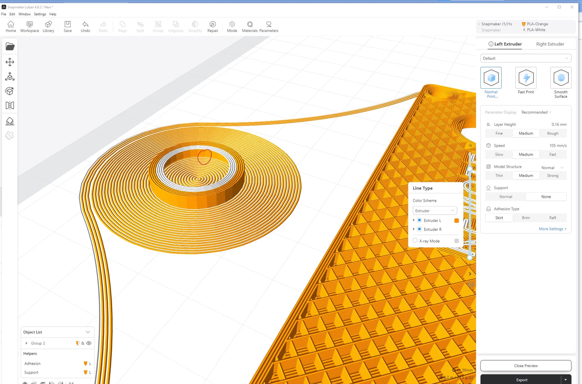

I just got a chance to load up the 3mf files they way you did and it worked and aligned once I un-grouped but then noticed another issue.
When I slice the prime tower shows the main body priming and the letters don’t prime at the start so the first layer on the prime tower when the letters are started is un-supported (See screen shot). So I can see the white just drooping down into the abyss and not really priming but rather drooling… It does this with both Model types so this is a slicer issue.
Don’t know if there is a setting to run prime tower when there is nothing to print but to create support. Or does it really matter?

Nice! Regarding the oozing of material in the prime tower, i think it’s intended functionality to save time and material. Cura does the same…
