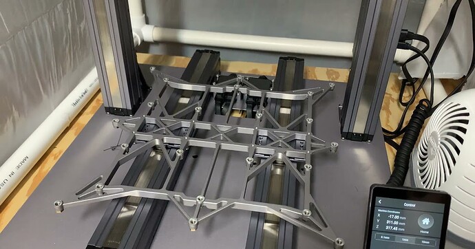

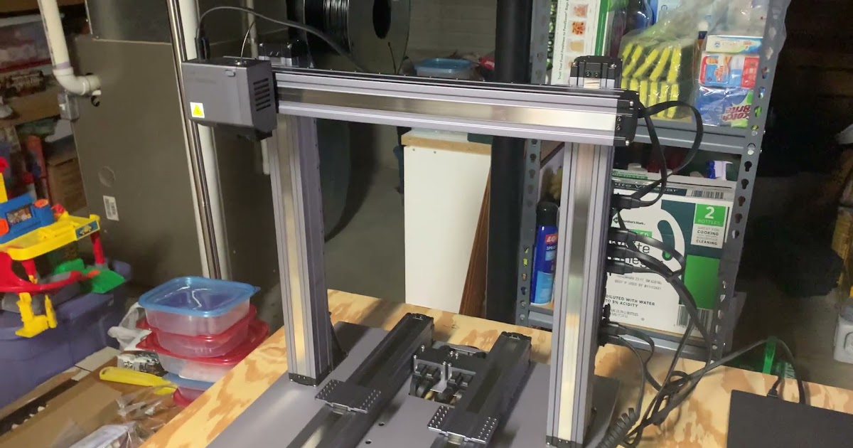

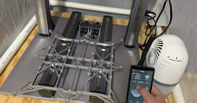

I have had my snapmaker 2.0 A350 for almost a year now, I got it in October 2020 and I have encountered my first major problem. When I booted up the machine this morning and began the homing sequence it moved along the x-axis fine and along the z-axis fine but then when it went to move along the y-axis it made a loud hum. I noticed that the bed didn’t make it to the edges of the boundaries and instead was in the middle. I then moved it manually with the touchscreen. The bed is able to move backwards but then when I move it forward it will get stuck in the middle again.
So I tried to move it to the top and while it moves up you can see it kind of shimmy, like something isn’t aligned possibly. When I move it by 1 mm it moves with some noises but then when I move it with 10mm it moves with a sort of grinding noise and sometimes wont even make it the 10mm. I will attach some videos and hopefully they will play for you, first time really uploading to the forums with a question.

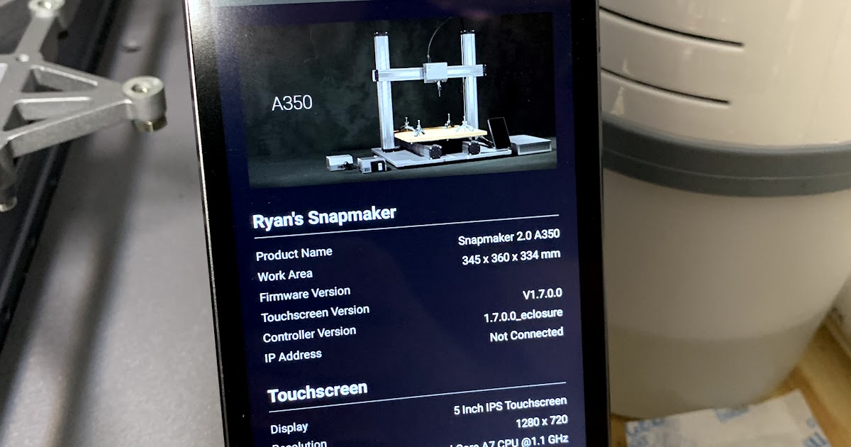

Touchscreen Info:

@brent113 So last night I took off the carriage last night to allow the modules to move independently and it turns out one of the modules isn’t moving at all while the other one moves fine. The left one is also easy to move along the linear module while the right one has a lot of resistance when moved. I have opened a ticket with support and am in contact via email in case it is a bad module I can have it replaced shortly. I received my snapmaker back on october 5, 2020 so it should be under warranty.

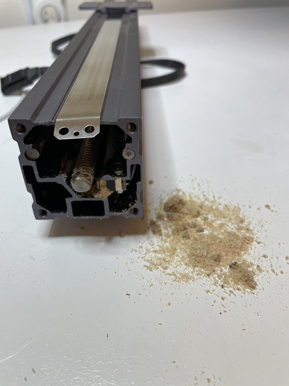

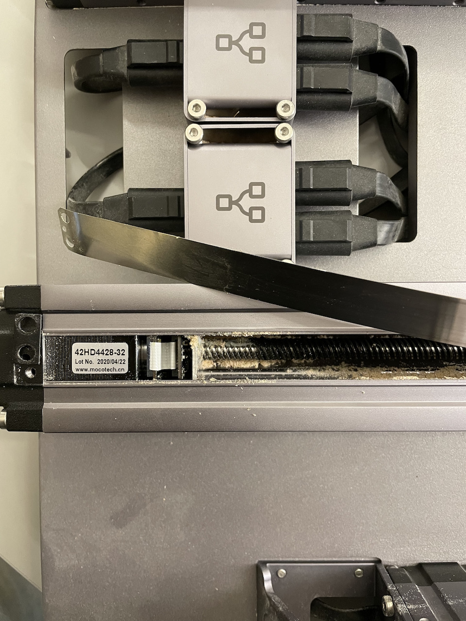

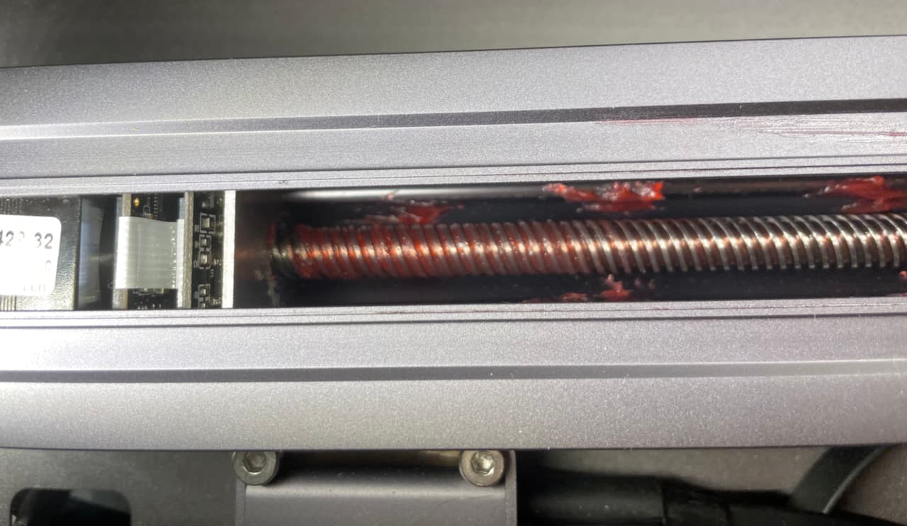

I had a similar problem - the y-axis linear modules got stuck.
To diagnose the problem, I took a peek inside one of the modules, and found lots of dirt and debris. See picture.
I then removed each of y-axis linear modules from the machine, disassembled it (following several youtube videos), cleaned the grease and debris with white spirit, dried it, reassembled and applied fresh grease. See picture, just before sealing the module.
Problem solved.
Nicely done, my hat off to you - as someone who has disassembled two linear modules and been wholly unable to get them back together in an adequate fashion - for example the black/white end stop switch cable touching the screw at the driver end. I have not been able to undo the end stop switch bolts to enable me to pull the cable back to that end
I am impressed.
My takeaway is for me - don’t do any carving if the result is crap in the linear units cause for me the basically unserviceable, i just don’t have the skills.
Yeah, if dust from CNC routing can get into these things so easily, maybe they should be more user-serviceable.
Maybe they need to learn about felt-pad wipers for the module carriages :slight_smile:
