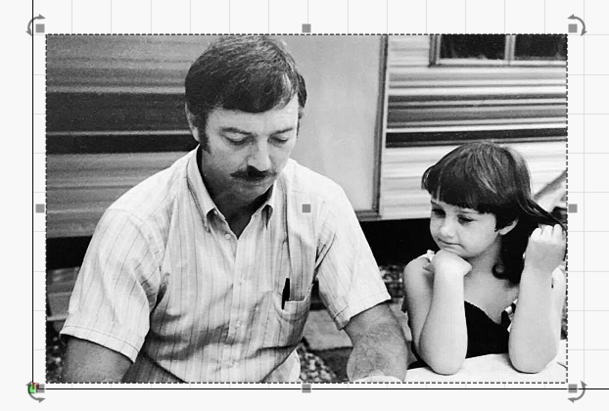

I’m having trouble getting LB to work with exported GCODE opened in Luban. I could have sworn that I read that this is fine to do, but I can’t seem to find that info now. The reason I’m doing it this way is that I just want to send the file with WiFi.
Here’s what I’ve done:
  1. I’ve followed the advice to set it up here: Snapmaker 2.0 A350 Setup Guide - Snapmaker - LightBurn Software Forum
  2. I import a photo.
Here is what it looks like in LB:

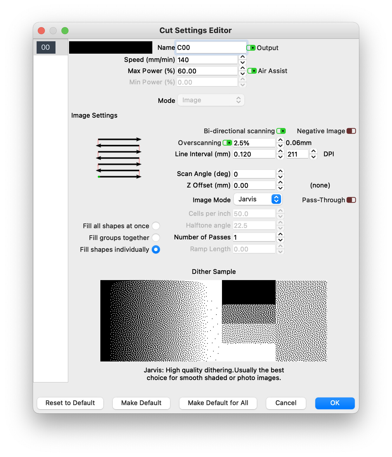

  1. Here are the cut settings:
  1. I save as GCODE.

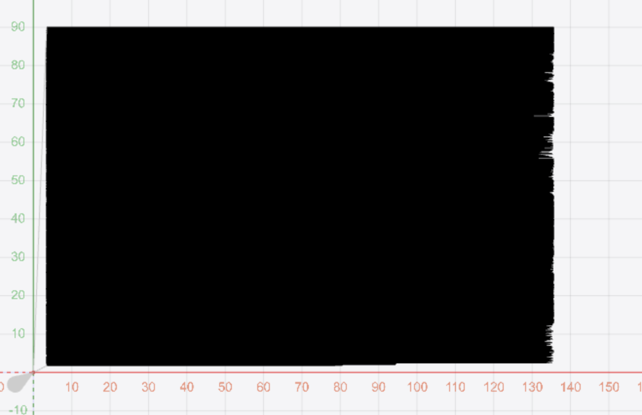

  2. Rename file from .gc to .nc
  3. Open it in Luban Workspace. Luban’s preview is just black:
Given that Luban can’t render the GCODE preview, I’m hesitant to even send it to the printer for fear of causing a problem.

Luban preview may just be showing you the toolhead path.
So it would be black everywhere the toolhead runs which on a grayscale photo would be the whole thing.
Ah! Good explanation! I bet that’s it!
