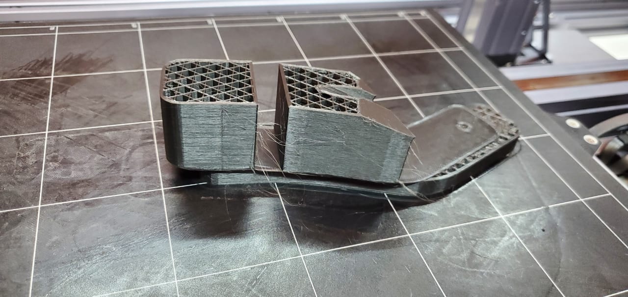

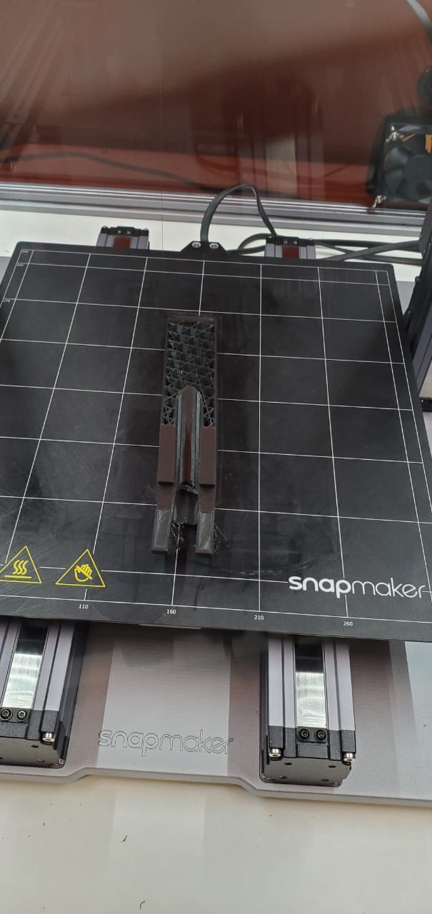

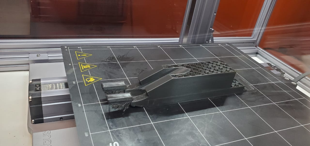

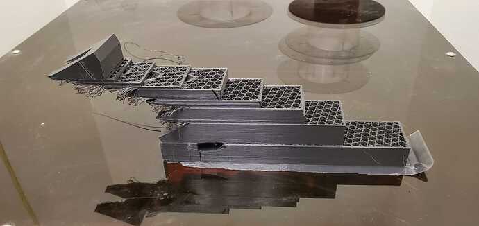

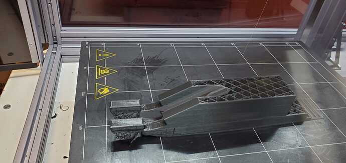

Hello everyone, I dared to make a publication because I had layers shifting problems, the first time it happened to me I had not changed any of the parameters that I use regularly, it is worth mentioning that I have always used Luban, I have done many tests in order to solve the problem from resetting the machine, using z-hop retraction, printing at different qualities, temperatures, calibrations, I even got caught up in cleaning the “y” axis modules because I had seen it in a post that had worked. Finally I tried to reset the machine and with the deafault parameters. I hope you can help me, I really feel a little frustrated.

@MooseJuice @Deth its another one. @mauricio first thing you need to do is swap your splitters with each other. I will take a look at the files in a couple minutes. I’m pretty sure I already know what the problem is but we need to eliminate all other possibilities first. @staff can you pull me and the poster into a private chat with you guys just as you did with me and the other user that had this issue before, that was when Edwin was here so you may not know of it but I diagnosed this with another user.

My layer shifting problems on the last round were declared a slicer problem, but honestly I have had so many rounds of linear modules failing for a multitude of reasons.
@mauricio swap the y axis splitter with the z axis splitter.
Thanks Artezio, I took your advice and I started a print. I will see the results shortly, waiting for them to be satisfactory.:crossed_fingers:
@mauricio k let me know.
@mauricio how did the prints come out?
hello Artezio
I tried but the printing still did not go well.
@mauricio ok, contact support. You likely have a bad controller.

I don’t think it’s a slicer issue, he’s most likely got a bad controller. This is like the 6th one. Couldn’t hurt to try the gcode and model though.

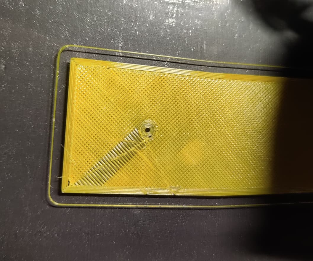

at 10% infill with 3 shells im at 7.5 hours… I see no reason to go any less than that, but if you tell me what your infill was i’ll check it. If i had to guess i’d say maybe yours is 5%. 10% looks like this:
Sorry to say but luban is an absolute joke!
Oh, edit again - I thought the gcode and file were of this recent picture with this awful looking infill, so that is interesting.
You were using a different model for this picture. Can you share THIS gcode and model too? I am going to let the first one run for awhile but not 33 hours.
omg look at this crap, its on line 3 now. just decided not to bother filling in over here on the previous layer.

Did you pause and then resume printing for some reason? With the door recognition switched on, the door opened or something?

Ill fiddle with this a bit for funsies… but it may legit be a bad controller… i was printing your other gcode shape without any shifting problems.
