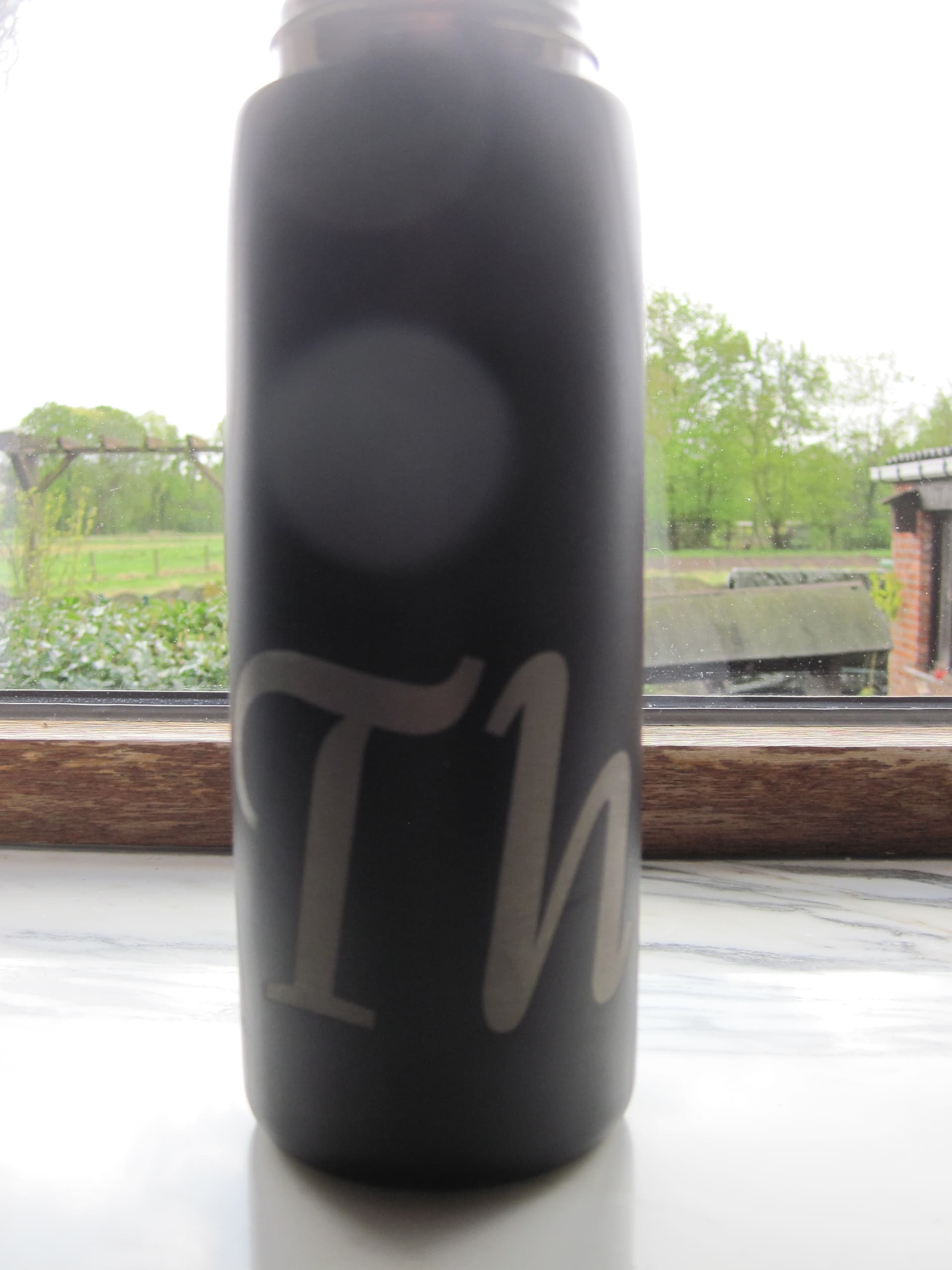

Camelbak bottle on rotary module. At the moment Lightburn support the rotary encoder only in Snapmaker Marlin modus. Not in GRBL or Marlin. They haven’t a B axis that is need for the rotary. You can work around but it is extra work.
Power 20% speed 3000mm/m. More power deforms the bottle.
