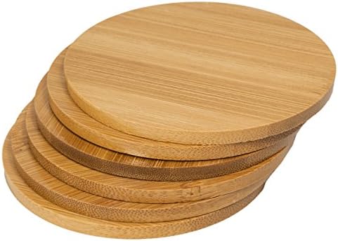

greyscale works - but it’s slow. This is engraved on bamboo coasters.
It looks even better on leather coasters.
get the focus right, set your white clip, I used FloyedSteinburg with a dwell time of 20ms, a work speed of 800mm/minute, and burned with a laser power setting of 100% for bamboo and 70% for leather.
here is the result and the original greyscale.
Excellent post. Thanks for that. How did you acquire the raw coaster material? Pre-cut at some online retailer, or did you cut the circles with cnc?
I got them from Amazon. The bamboo ones are from Amazon, sold in a 6 pack (though the round ones are all gone, and now they have square ones). They weren’t very flat, and after I engraved a bunch, I did a drink test and was unhappy with the likelihood of spilling a drink. So I switched to leather.
The leather ones are Tandy 3.5" leather rounders. A 25 pack was $34.95 with free Prime shipping.
