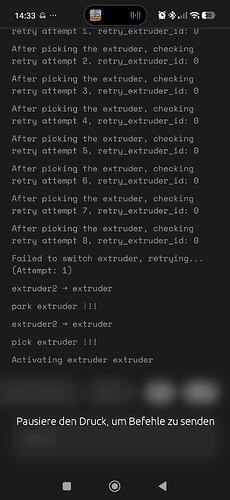

During the current 3-color printing process, I noticed that the printer has to grab the first head 2-3 times.
It picks it up, moves forward a short distance, waits briefly, re-inserts it, and then grabs it again.
The console shows the following:

Surely not. Isn’t this a problem with the pogo pins not making contact properly, so it retries until they do (or it gives up)?

The U1 firmware monitors the electrical contact of the pogo pins during head pick-up. If a bad contact is detected, it replaces the head and tries again up to two more times. These retries are seen in the Fluidd console (as per your screenshot). This is normal.
The pogo pins are only for the control and monitoring of the part fan (fitted on the toolhead). The heat-break cooler is a separate fan in the toolhead. The pogo pins are inevitably not 100% reliable, and retries will generally overcome the small percentage of unreliability. If, however, they fail to make proper contact after three attempts, printing continues but without the part fan running on that occasion.
