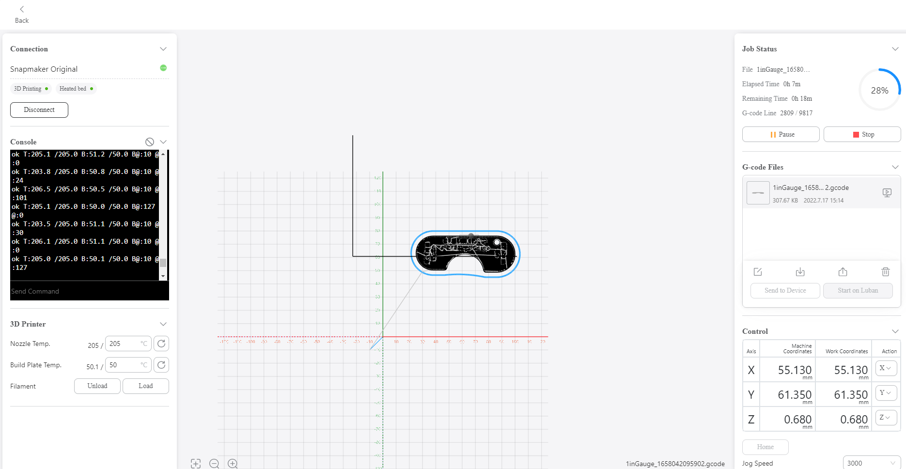

Having issue with the gcode loading to workspace but is not centred as it normally would be.
Not sure if this is something im doing wrong or if it is a bug, as I have not used my printer in a while and I just updated to the lastest version before trying to print and now I am at a road block.
Any ideas?
Screenshots showing pre and post gcode load to workspace.
Note: the red arrow on the third screenshot, thepreview shows it fine but you can see the travel line heading up past Y+100
Close the preview and it is just trying to waste my filiment…
I think I may have answered this myself, Looking itn the machine settings, it seems to have set itself to a snap maker 2.0350/350…
Changed it to suit my machine and it’s all “G”.
