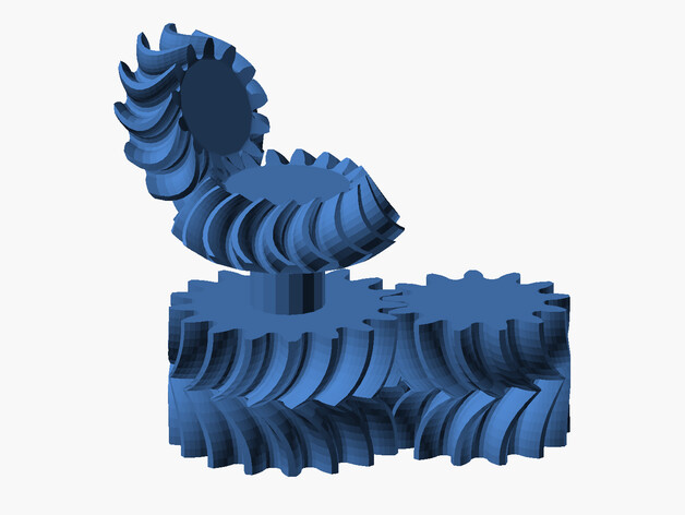

1 - Has anyone used Sketchup 3D to create print files that will work on a Snapmaker.
2 - Has anyone made high quality small, about 1 to 1.5 inch diameter bevel gears? I need precision teeth with near zero backlash for a proof of concept model of a device similar to a differential. Very low loads and low RPM.
3 - Is there a nozzle available with a smaller orifice than .4mm, say .2 or .25 mm? I would need something like that for the precision gears I need to make.

Yes, and then I transferred those skills to Fusion360 which I think is far superior. Sketchup works fine though if you’re comfortable with it.
Not in sketchup, there are models on Thingiverse that generate gears in OpenSCAD:
http://forum.openscad.org/adv-PolyGear-a-fresh-new-library-for-spur-and-bevel-gears-td27203.html
Yes, search Amazon or your favorite retailer for MK8 nozzles. They are available in a wide variety of diameters.
What does “near zero backlash” mean to you?
The snapmaker’s minimum layer height is 0.05mm, which to me implies that’s its max X/Y resolution as well. If’n you work in imperial, that’s about 2thou. That’s not good enough for Abom, but it’s good enough for the girls I go out with.
Printing 1 inch models with a 0.4mm nozzle should work fine, as long as there’s no detail on the gears smaller than 0.4mm. The slicer knows the diameter of the nozzle, and takes it into account. You will want to make sure you have your calibration, extrusion, and first layer flow dialed in. Otherwise you can over or under extrude, which will mess with your dimensional accuracy. You only need 0.2mm nozzles if there’s some feature that small, like the teeth of the gear need to come to a 0.2mm point, or you want some very small raised text.

Fusion 360 has a gear generation module that can be downloaded and installed from the Autodesk app.
I have created a bevel gear and a spur gear.
Please check it out.
