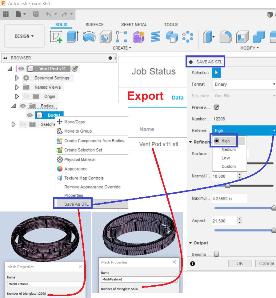

  1. You should give a shot to a parametric modeler. If you know and love SketchUp, that’s fine, but defining models parametrically is much easier for parts like you’re making. For example, define the race cross section as an offset from the ball bearing diameter, then extrude by rotating about Z into a solid shape. If you ever need to modify, change the original cross section and everything else updates automatically. Fusion and FreeCAD, and others, can do this.
  2. Circles and arcs are exported to .STL, which is a triangulated format with no curves. This is where the curves are flattened into segments, as it’s leaving SketchUp. Luban is not generating segments for curves. I don’t remember if there are STL export options in SketchUp, but in Fusion360 you choose the number of facets (indirectly) when you export to balance between file size and smoothness of curves.

You should look into SubD or some other way of increasing the number of facets in the geometry since SketchUp doesn’t natively support variable export resolution.
