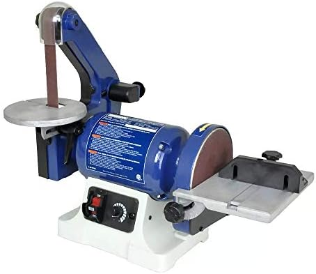

Just curious-which tools are you thinking of for PLA sanding? Recommendations I’ve seen so far (and what I’ve tested) are just stepping up from 120 to 1000+ grit sandpaper, and not using anything high powered to avoid melting the plastic. Dremel is OK if you’re careful for taking off specific bits, and I’ve drilled out holes to make pegs etc fit better, but that’s about it so far.
I don’t use PLA very often, preferring PETG. However I have a belt sander like that in the garage with a variable speed knob. (Can’t find any brand information on the one in the garage though so just found a similar looking one on amazon…sorry if it sucks(Check for local pre-owned ones as well, got mine a thrift store for 70$))
I probably wouldn’t use it for fine sanding on the plastic, but removing the burs and getting it to “hand sanding” levels on something your size would take like…idk 5 seconds maybe 10 given the curve?
OK, I see what you’re thinking. Might work, but meltiness probably depends on speed. Going to try doing this by hand (broke some of the supports off already). See how it goes. I used one of the other failed bits to test sanding/painting, and they seemed to turn out OK.
