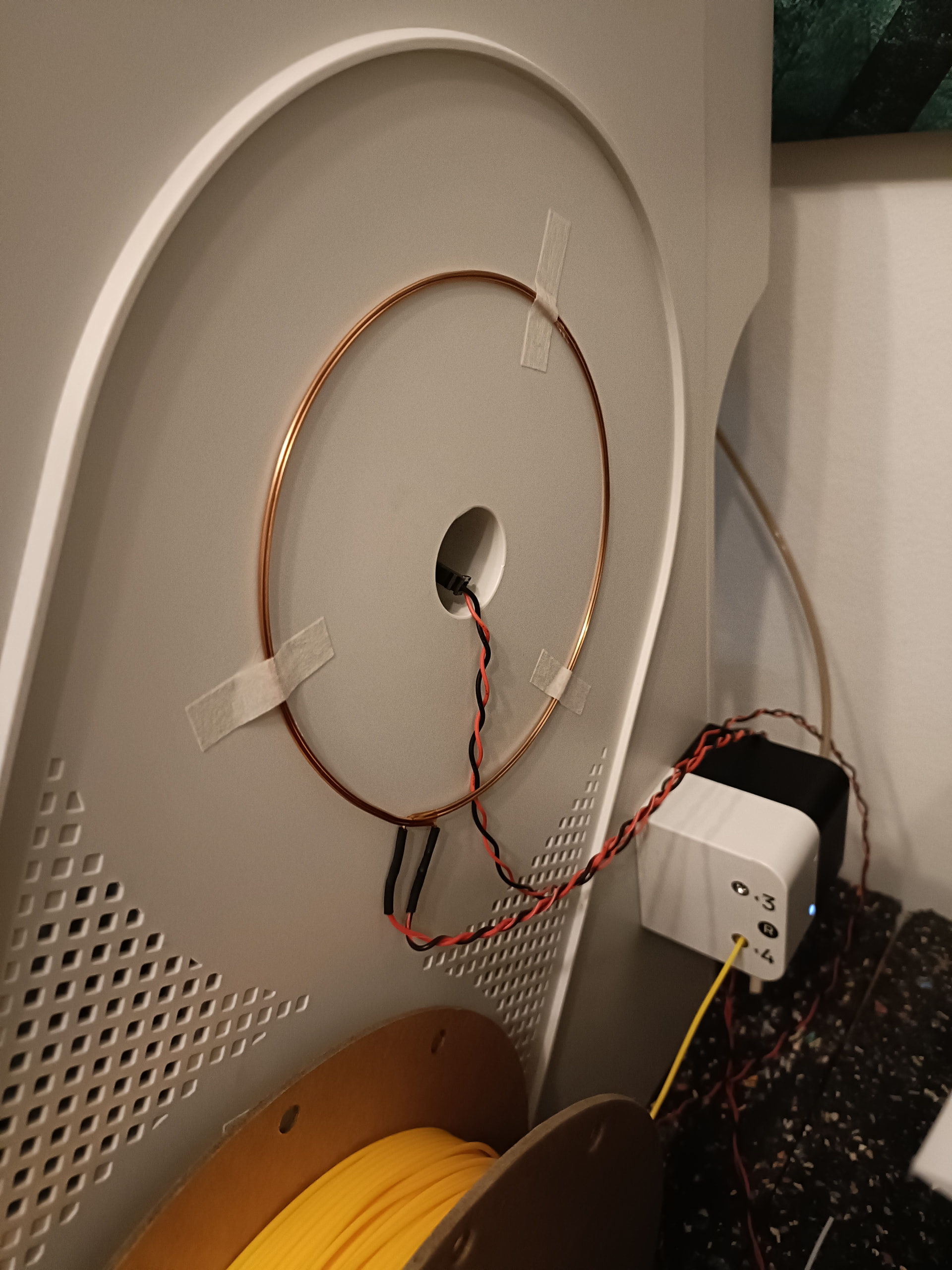

I simply don’t have enough space to run the U1 with the side spools and feeder attached on the sides but I’d still like to use the feeders and RFID filament recognition. I have a Ikea Bror Shelf setup with spool rollers in boxes for 4 filament spolls on top and I’d like to put the U1 in there but like I said there is not enough space for the feeders and spools on the sides.
As a first step I tried to extend the wires of the RFID coils to maybe 1 meter. The connectors btw are JST-GH 1.25 2pin ones. I just soldered them off the coils and soldered on longer cables with a microfit connector on the other side. The original cables also received microfit connectors.
I made sure to solder them on the correct ends of the coil and fitted them outside the side panels in the correct direction just for a test. I also checked + and - of the plug and there is continuity like expected. Unfortunately now the filament recognition doesn’t work anymore :frowning:
Any ideas why and how I may get them to work with longer cables? I had one reply over at discord stating that the cables resistance and capacitance is probably something that is tuned with components on the board, so changing the length might “detune” the coils..
Any ideas if I can solve that somehow? Maybe tweak a value in software? Or somehow amplify the coils?
Nice project, I like! Just to understand (I do not own a U1, cannot look myself): The coils we see are the original coils from the printer, just moved to the outside? I’m surprised how large they are, how thick the wire is and how few windings they have. On the other hand… if you look at standard NFC reader modules for Arduino, the PCB coils do not have many more windings…
That said, typical NFC/RFID chips work at 13.56 MHz, and this frequency may require a shielded coaxial cable for longer distances (not really an expert, take with a grain of salt! but this page: Produkte: RFID Antennen – ubisys RFID seems to support my assumption).
Do you perchance own or have access to an oscilloscope? You could compare the signals from an unmodified antenna to your modified one. If the cable is the problem, I suppose you’d see the deterioration of signal quality.
Yes, these are the original coils, just moved outside for testing purposes.
Interesting idea, I didn’t think of that, since the short ~ 20cm original cables also didn’t have any shielding. I have cat5e lan cable at hand, first though I’ll fabricate new short,”stock” cables again, just to rule out any other errors on my end.
Unfortunately I don’t have an oscilloscope, tbh I wouldn’t know what exactly I should compare :smiley: I’m an electronics noob, but maybe it’s time to get an osci.

So I did some testing today with shorter cables and cat5e cable. The longest I was able to extend the default ~20cm cables was +40cm….so too short for my use case. I need min. +80cm. It made no difference if I used normal cable twisted, or cat5e cable.
I don’t think I’m able to retune the frequency, I have no oscilloscope and I don’t plan on soldering capacitors on the mainboard or the left extension board.
What do you think, is it worth trying such rfid antenna cable like @Hauke mentioned? Or am I out of luck here?
Could I maybe solder sth. in between the wires? If I understood correctly it needs to be sth. that reduces capacity since the longer cables likely add more capacity themselves.
