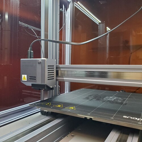

How can I change the starting z-height when performing manual bed leveling?
I want to change the starting position of the Z height of the 3D printer head when performing manual bed leveling.
I want to add a MDF board, approximately 2cm thick, underneath the print bed of my 3D printer in order to level the bed.
Adding the MDF board will increase the height of the bed by approximately 2cm.
The issue is that when I perform manual bed leveling, it automatically moves to a lower position as shown in the picture below.
I want to be able to start manual bed leveling at a position 3cm higher than the current position, as shown in the picture below.
If anyone knows how to do this, please help me.

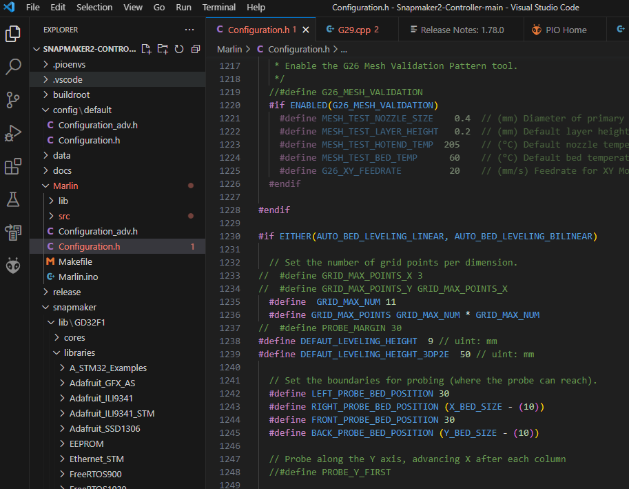

  1. I tried changing the “DEFAULT_LEVELING_HEIGHT” value to 50 in the Snapmaker/Snapmaker2-Controller/Marlin/Configuration.h file (line 1238).
    This variable is used in the “reset_bed_level()” function in the …/Marlin/src/features/bedlevel.cpp file (line 148).
This had no effect.

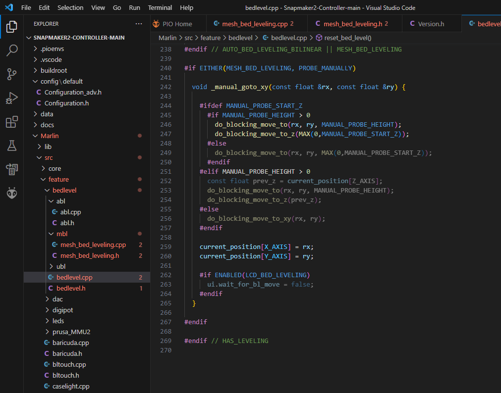

  1. I tried changing the “MANUAL_PROBE_START_Z” value to 50 in the Snapmaker/Snapmaker2-Controller/Marlin/Configuration.h file (line 808).
    This variable is used in the “_manual_goto_xy()” function in the …/Marlin/src/features/bedlevel.cpp file (line 247).
This had no effect.

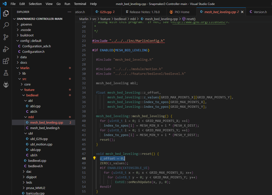

  1. I tried changing the “z_offset” value to 50 in the …/Marlin/src/feature/bedlevel/mbl/mesh_bed_leveling.cpp (line 48).
This had no effect.
  1. I tried changing the last parameter of “onMeshUpdate()” value 0 to 50 in the …/Marlin/src/feature/bedlevel/mbl/mesh_bed_leveling.cpp (line 53).
This had no effect.
