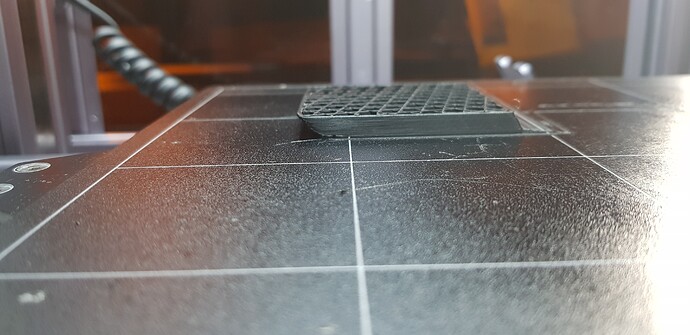

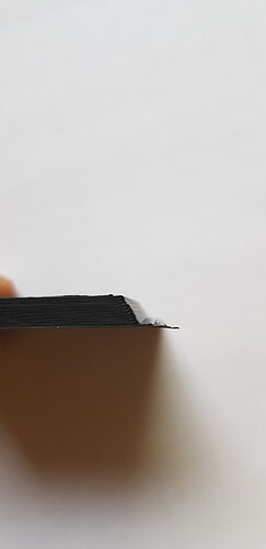

HELP Layers out off line

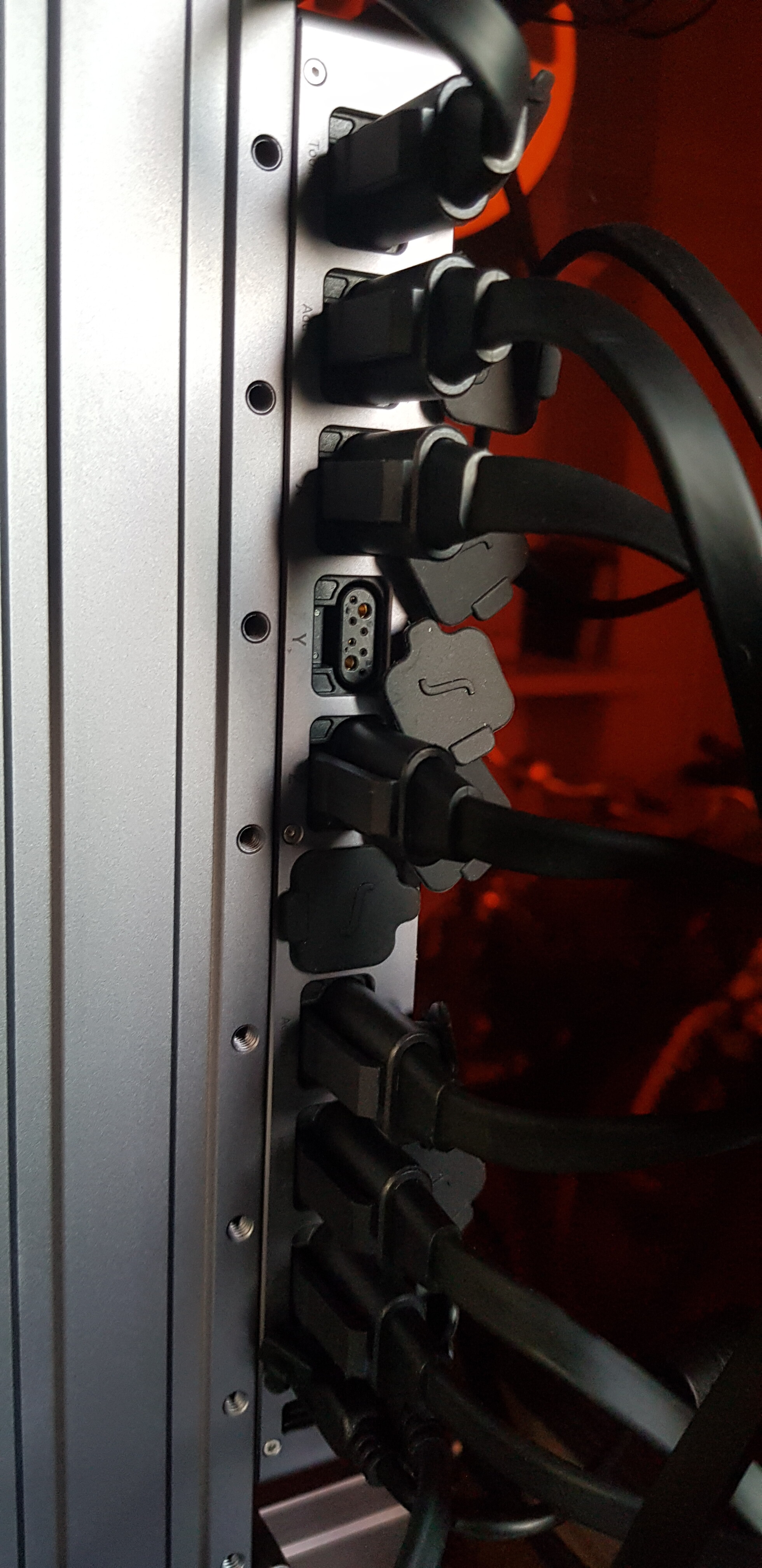

Show me how you plug the cable on the controller.
Did you update the firmware successfully?
Did you swap the Z converter with the Y? If your G-code is generated by Snapmaker Luban, we suspect that the Y converter may be the issue.
Please swap the Y converter and Z converter.

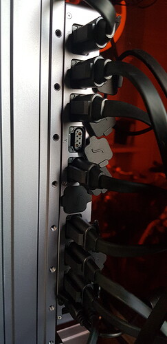

Swap the converter as pointed out in the picture below.

The converter was swapped, checking all cables. start print via pc connection

The calibration cube gcode is generated by Snapmaker Luban V3.14.0, and I did it.
You can also swap the conversion cables. We think the electric pulse signals lost.
Edwin
I disconnect the enclosure,
swap z-cable and y-cable. must I
plug the y-cable into add-on 1?
Yes, please keep the Y axes cable in add-on 1 port as you are using the testing version firmware.
