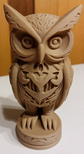

I replaced the nozzle with a hardened one and printed with it without any adjustments (except setting the temperatures according to the specifications on the filament spool for the new material, Sunlu PLA Wood, Support PETG). The result was very good. It doesn’t look any worse to me than the other prints.
After the nozzle swap, I performed the full calibration, as if it were the first time out of the box, and also ran the automatic dynamic flow rate calibration.
I’m a beginner, so maybe the experts can provide some improvement tips. For me, it worked relatively foolproof…

@LutzHB seems like you’re on the right path! Also, that owl looks amazing :sign_of_the_horns::sign_of_the_horns:
