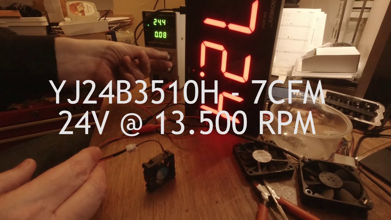

Opened PSU and found 25x25x10 and 60x60x10 fans
Going to replace with 40x40x10 and 60x60x15 by EBM-Papst
Fans
From 35 en 30dB to 16 and 22 dB with more CFM
unplugged the 25x25 for now (see https://youtu.be/nQoWT_Vo8YY)
PSU did not get over 33C while 3D printing the new backplate for 40x40 here:
make that over 70dB-A for the smallest one
