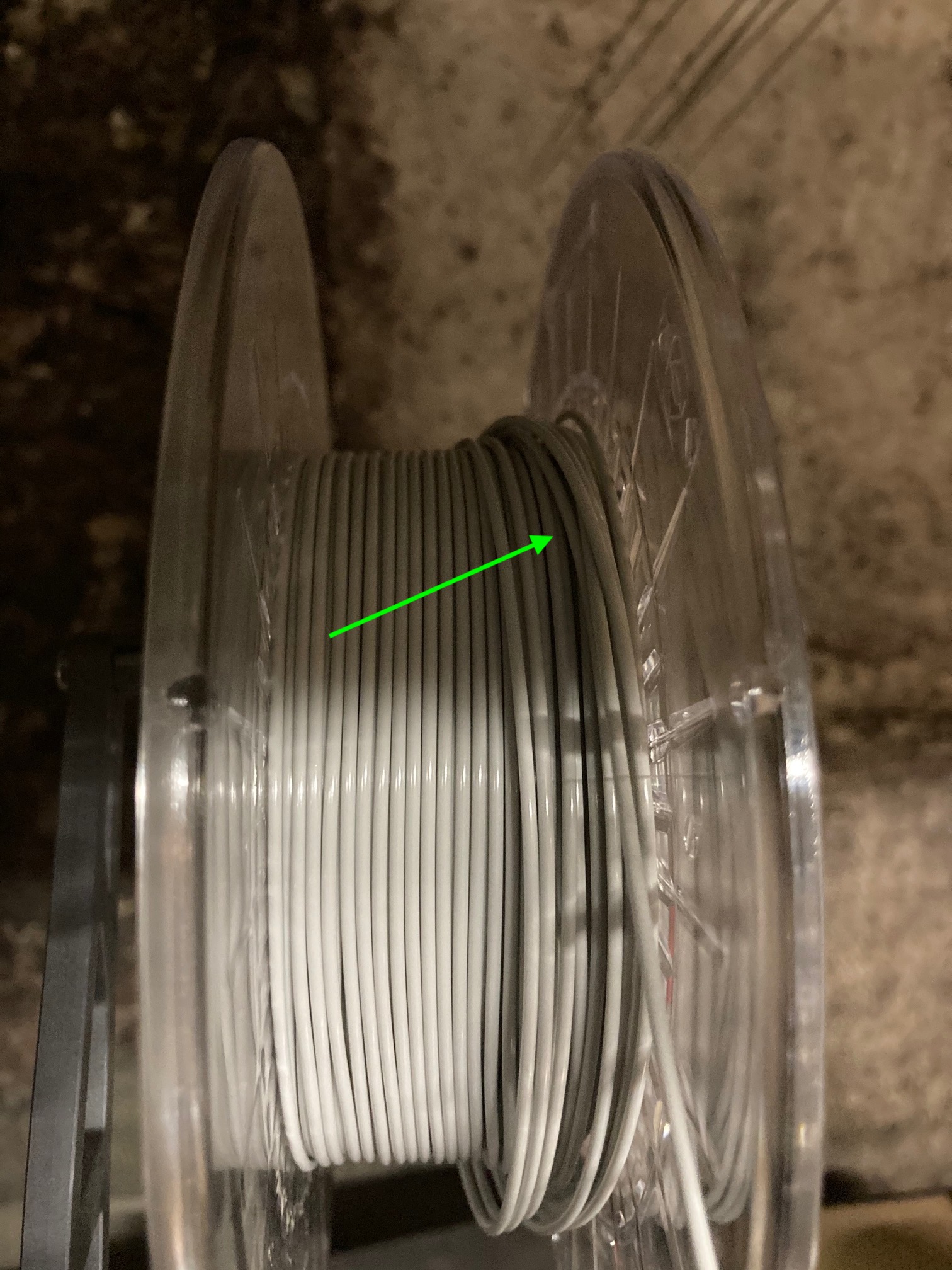

I have found the machine this morning in a quite unusual state… I may say this might be one of those unlucky event. Hoping to find some solution here. Spool is Fillamentum PLA. Been very pleased so far with the brand.
As you’d expect, the filament in the spool has almost no tension when not connected to the machine, making the first couple of layers able to move around and sometimes mixed up/out of nice order. Most of the time, while printing, the line of filament leaving the spool for the extruder finds itself below a line of filament, creating a certain tension in the spool. I’ve never had any issue, most of the time the tension is released by itself as the filament moves around the spool.
Well, that was until yesterday! During my last print (I was not present) it appears that this tension never released, making the spool unable to rotate on the axle, making some sort of knot if I may say. But the extruder gears kept pulling until there was so much tension that the filament separated just short of the extruder. The spool then kicked back and managed to leave the axle and fell on the print bed.
I found the machine like this with substantial damage to the inside of the print head.
I have attached a couple of photos, with one showing the filament lying under itself as it leaves for the extruder.
I would like to hear your thoughts on this issue, and I would like to find a solution to this problem so that I do not cause more damage to the machine. How can I keep the filament nice and tidy, when in use and not in use?

Don’t know how you can fix the tangling, but adding a more substantial spool holder with an interior diameter smaller than the knob at the end of the axle would at least make it more difficult for the spool to fall onto the print bed. Thingiverse has several patterns.
The problem is the loose filament on the reel. You need to keep it under tension.
Unwind while keeping tension until you get to the original winding. Then rewind carefully making sure it isn’t crossing over itself.
As long as the printer is keeping a little tension while printing it should be fine. When the print ends and the head goes back to home, that’s when it can get slack again. Check before every print that it’s correctly wound.
I haven’t had a problem with having a smaller mount than the reel hubs. (I am using bearings on the original SM shaft) but you can find mounts on thingiverse that match the size of the reel hubs so that the tension is always constant.
If you keep the spool stored with the end fastened down it helps keep this from happening.
That only happens when the end of the filament goes under an existing loop on the reel then it can lock just like a knot. Best way is to avoid ever leaving the end loose. when you remove the filament from the print head always immediately clip it into the holes in the outside edge of the reel. When you start a new reel, hold on to the filament after unclipping it and put it in the print head. Dont let it spring back on to the reel.
