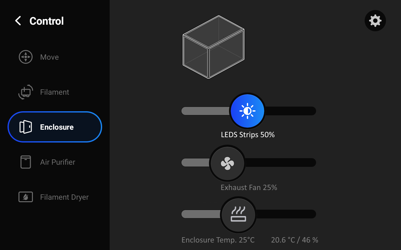

Yes, I can mimic any snapmaker module, and there is drybox module, possibly SnapDryer, that enabling this controls in hmi:
Strange values ‘cause I’m not sending it from my device, but I can manage it.
Problem is that I want to control this device through gcode, not only in hmi, but seems that there is no gcode for it.
And yes, you can adapt any drying box to control it from hmi, you just need an arduino and write some code :slight_smile:

The screenshot you shared from the HMI: Is this available only with modifications, or is this “factory default”? I only own a SM 2.0, so never have seen that anyhow…
Yes, it’s factory default Artisan firmware, but i’ve checked it on SM2.0, suddenly, drybox is not initialize with it. So, you need Artisan or greater for this feature, or you can ask devs or make fork of GitHub - Snapmaker/Snapmaker2-Controller: Snapmaker2-Controller is the firmware for Snapmaker 2.0 3-in-1 3D Printers. and add it into code. (But drybox will not available on hmi, devs never release hmi source, so, only gcode commands)
