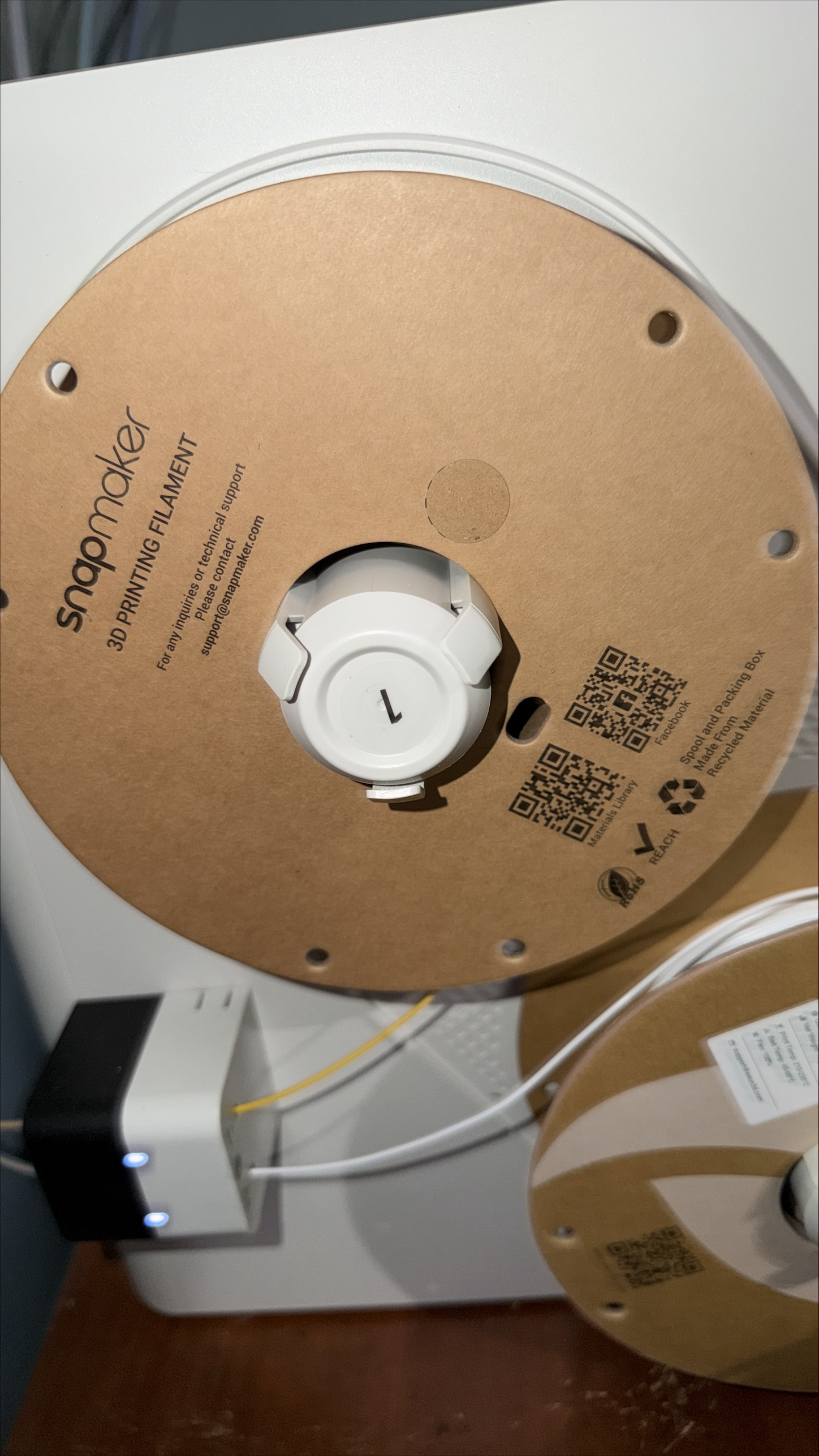

I am still working with Snapmaker support; however, I just got another G-code sample to try, which I am about to do with some of my remaining pack of filament. I hope it finally works, but here is the issue: this printer has settings that SHOULD work, especially with their own filament out of the box PERIOD. It doesn’t in my case. I don’t mind tweaking things, especially with the 3rd party filament (I’d expect that), but this is beyond tweaking. It can’t even print at the advertised speeds at this point. SO, what is beyond the tool changing? For me, I don’t know, the issues make it not really worth it. Again, and I cannot restate this enough, the concept of this printer is AWESOME. I am just having a bad go at it. Since I am having a bad experience, I hope everyone else can learn a thing or two from it; I know I am. OH, and shout out to Snapmaker support, they are trying to get this thing working to spec without having to hire a priest from the Vatican to remove the demons. BTW, because it was asked, my ambient temp at my house is 74 degrees F (a bit more than 23C).
