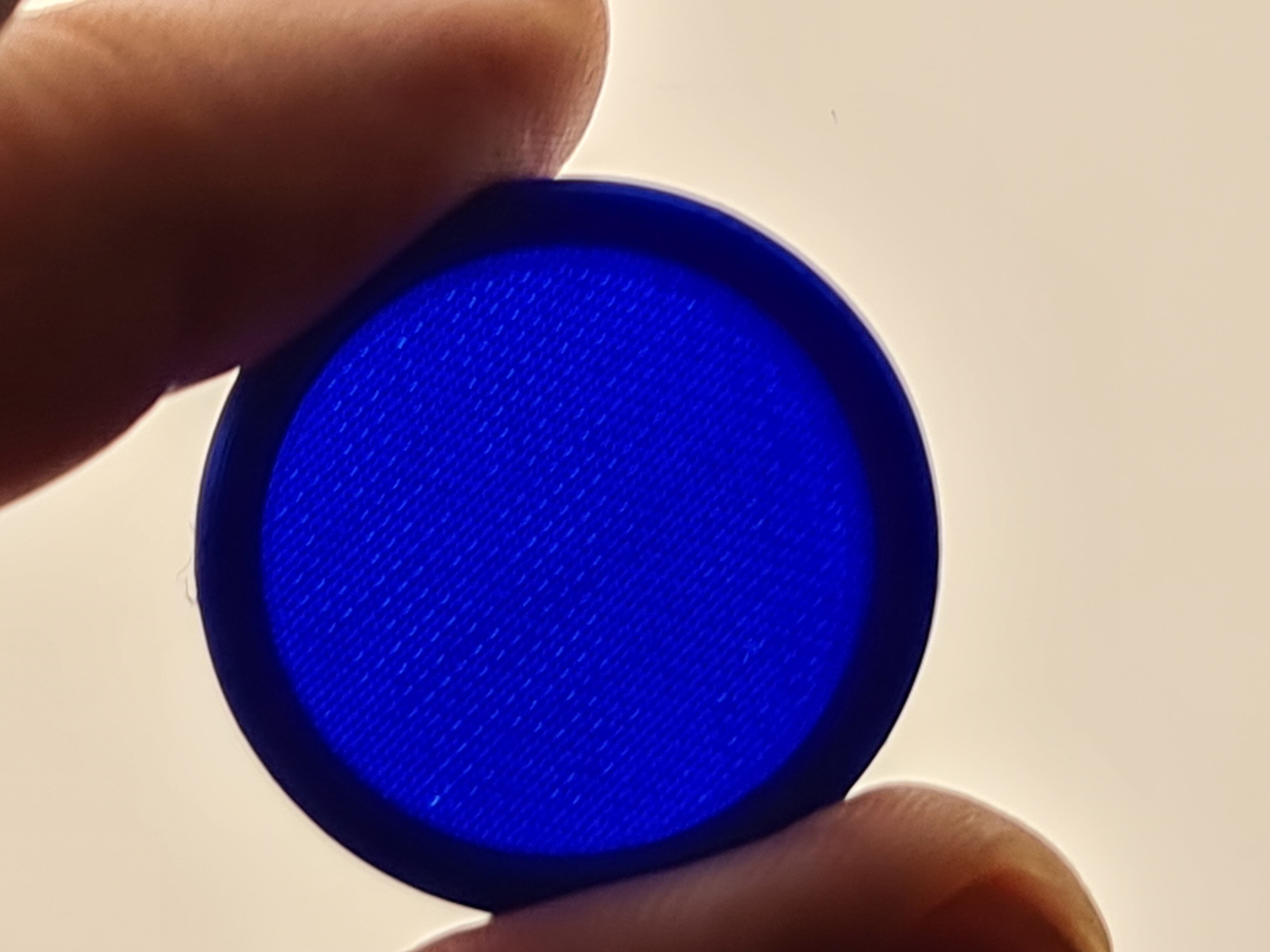

After the last firmware update I forgot to re-calibrate and found a way to describe how important the calibration is. At least the E-steps should be in a good range.
I was printing a part with TPU desingned to be water proof (cap for bottles).
With uncalibrated extruder (M92 E212,21) the part was mor a strainer than a sealing cap.
Watch out for the light shinging through (my infill is not 45°/-45° but 0°/120°/-120° just if you are curious):
And here we have the (2nd version of the) same part with calibrated extruder (M92 E268.00):
Now the part is water tight…
PS: For TPU you have to reduce the extruding speed (I did with F100 instead of F300)!!!
