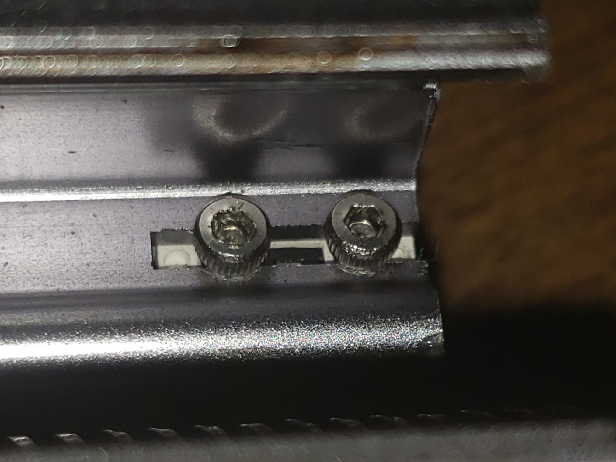

I wish I read this in full before taking mine apart. I definitely completely ripped out my limit switch :frowning:

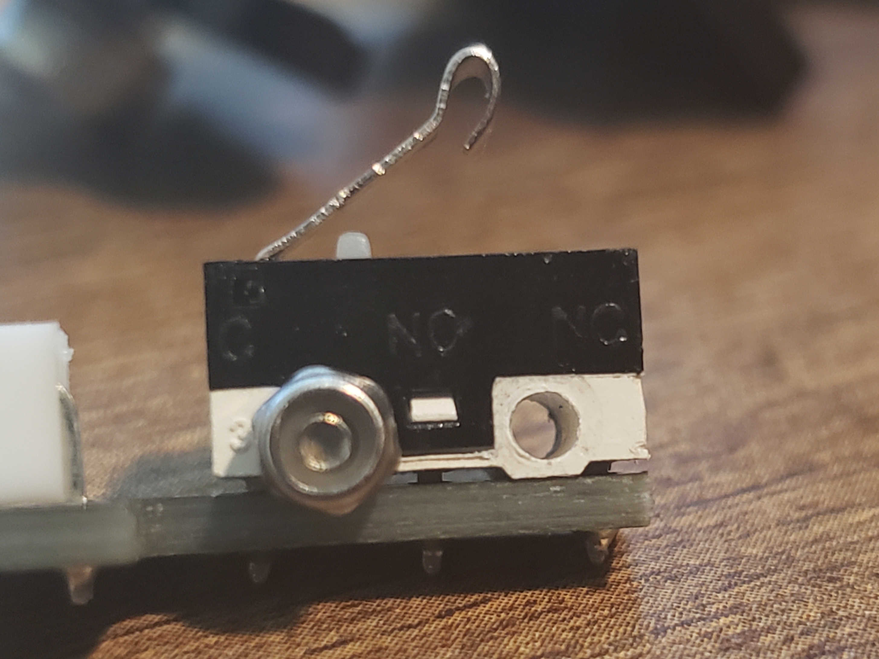

Great idea! I use Mouser a LOT, and it’s nice that I get cheaper 2-day shipping because they’re only about 200 miles away from me. However, the original installer stripped one of the screws pretty bad, and my ball-end hex key isn’t having it, so I’m going to just opt for a replacement this time :sob:
Cancel that. @brent113 You inspired me to try a different approach. My flat end hex key was juuuust able to grab the very bottom of that hex hole and it came out! I think some crafty needle nose plier bending of the metal part of actuator got me “good enough”. It’s reinstalled and clicking where it looks like it should!
You saved me probably $150+ plus waiting who knows how long on shipping. I owe you a beer sir. Thanks!
Hey while you’re in there, can you grab a part number off the switch or a dimension? Would be nice to finally be able to confirm or deny if that Omron switch would be a replacement for it.
The datasheet for the Omron D2F-01L that I was thinking is here with the full dimensions: http://www.farnell.com/datasheets/2340369.pdf
It’s close. The very slight difference in the width of the actuator makes me think the D2F won’t work. My actuator switch is just barely catching the corner of it; the carriage does not roll over the whole surface of the actuator, just the very edge.
I marked the “Invalid” measurement indicating the distance of my actuator from the body of the switch, which is not valid because I bent it and shaped it back, so my travel will not be what a new switch will look like. The width was right at 3.85mm though.
Oh yeah that def does seem to be the same switch used as the filament runout detection.
@MooseJuice
The filament switch and the linear module’s limit switch are the same.
