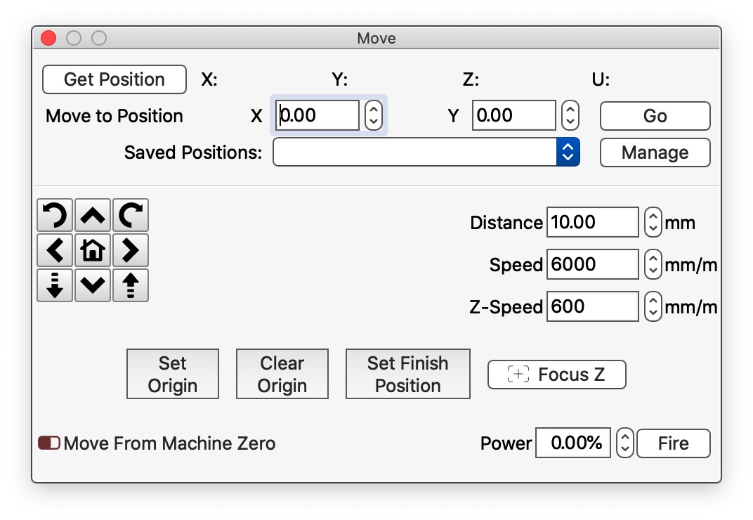

As it is, here is the interface for this aspect of Lightburn. The next three images show the some of the Lightburn GUI and the settings which can be made relating to Z height.
The first two permit one to set the Z height as the focus point. I want to design and print a power ramp for each setting adjustment in focus… say every 0.01mm of focus for specific materials. I hope this will prevent scorching or smoke damage. I also want to find out how to use the cut modality and see what gives the best results.
The power can be varied very easily so I will be able to build a library of materials and keep them in Lightburn’s library and just apply them when needed. Each of the tabs provides another pallet and there are three settings pallets including preferences that do not have a pallet on the left. The settings for Z Axis control are accessed for the screwdriver and spanner icon (tools)
