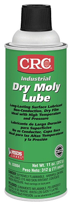

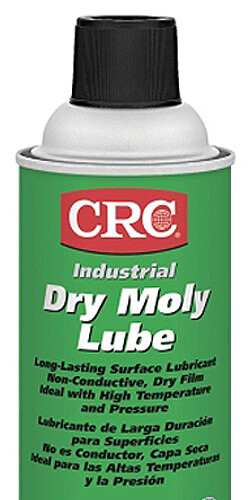

Here now a first interim report with video. I have packed the glass bottle in blue tape. The area to be lasered remained free. On this then three layers of Mos2. And off into the laser with the settings from above.
Interesting: I had accidentally selected 4 passes and aborted the process after a little more than two passes. In the area where the laser has already been three times, the Mos2 is almost completely gone, without any washing action. In the remaining area, vigorous scrubbing is necessary and it still does not come off.
Perhaps the easiest way to remove the Mos2 is with another passâŠ
Link to video Part 1
I will keep trying and report here in this thread
I have now successfully completed the experiment. Removing the MoS2 was super easy in the end. I just let the laser travel over the complete area one more time. In the process, the remaining MoS2 dried completely and became brittle. So I was able to strip most of it off with my fingernail. I scrubbed off the rest with a scouring pad. Any thinner, alcohol or the like was no longer necessary. The result can be seen.

Interesting. I donât think the brand I used reacted that way.
I also donât think it left that kind of or much residue even with a single pass.
Or maybe it was and I wasnât being that picky.
I wonder if itâs a slightly different formula.
Maybe thereâs a difference in the glass.
Iâll have to pay more attention next time I do it.
I just ran another test on this on Borosilicate glass, one run with the Dry Moly lube, and one with black Tempra paint. Tempra paint for the win! Same settings etc, the moly lube made a mark but VERY faint, and it was hard to get out of the cracks in the glass without high temperatures (an annealing cycle in a kiln)
The tempra is a little harder to apply evenly, but doesnât have nasty volatiles, marks MUCH better, and rinses off pretty completely.
