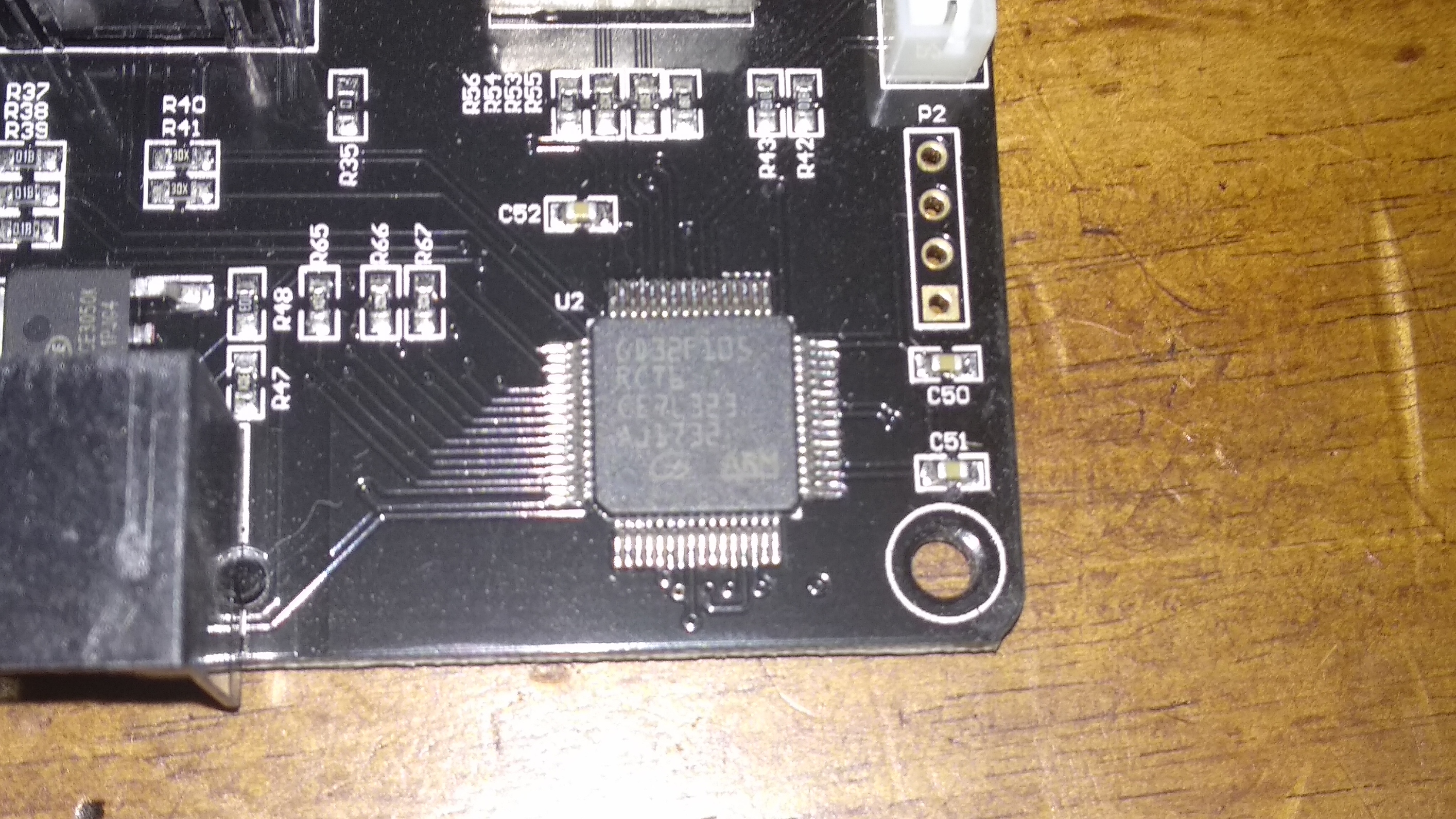

I am making a mount for a Raspberry Pi for my SnapMaker. In order for there to be room I decided to move my controller down to the bottom most screw holes on the back of the Z linear module. When doing so the case for my controller popped open. The plastic tabs that hold it open look to have snapped. I took this as a sign that I should take a look at the chips on this board.
First thing that surprised me is that the controller is 32bit. It is running a GD32F105-RCT6 which is an ARM Cortex M3 chip. They also have the single wire debug port broken out from the chip, but it does not have a header. I am currently trying to find a spec sheet for this chip, but the download links seem to be broken or in Chinese.
It also has four A4988 stepper drivers with a rather beefy heatsink running across them.
It only has two power MOSFETs from what I can tell. One is for the heated bed. The other is for the hotend / laser / spindle. There are some smaller transistors on the board that I cannot make out the part numbers on. As such it is still possible that they have the fans hooked up to them, but I am not holding my breath.

I am sorry but I disagree with you on that. The only things I see similar is that Makeblock uses phone jacks and the they have a module that uses the A4988.
The A4988 is an extremely common stepper driver. It is very inexpensive compared to other drivers (less than a $1 if I remember correctly). It is also well supported by Marlin. From a design perspective it is a very tempting choice to use so I do not see that as much of a similarity.
The phone jacks on SnapMaker are in no way pin compatible with any MakeBlock modules. The phone jacks on MakeBlock are strictly for communication and power delivery. Motor drive is done through a screw terminal block. The only jack on SnapMaker that does communication is for the screen. MakeBlock is all about compatibility.
The differences between the two controllers are pretty major as well. The SnapMaker is 32bit, Makeblock is 8bit. The MakeBlock has tons of extra IO, SnapMaker has none. The SnapMaker is 24V, MakeBlock is 12V. The list goes on and on.
I think the biggest thing though is that the MCU SnapMaker is using makes no sense for MakeBlock. It only has like 50 GPIO pins many of which are eaten up by other functions like talking to the USB chip serial chip and the USB OTG port. There seems to only be enough to talk to the screen and control the stepper drivers / mosfets. Makeblock on the other hand wants as much functionality in their controllers as possible. They also break out anything they are not using for you to solder headers to.
It is quite possible that the idea of using RJ25 / RJ45 connectors was inspired by MakeBlock, but I think that is about it.

I managed to open up my board and take a picture of the chip
I plan on replacing the board with a duet wifi and installing a bltouch but im waiting for the fw files to be released
@Turmud The data for that chip is available here:
http://cn.gigadevice.com/product-series/13.html?locale=en_US
