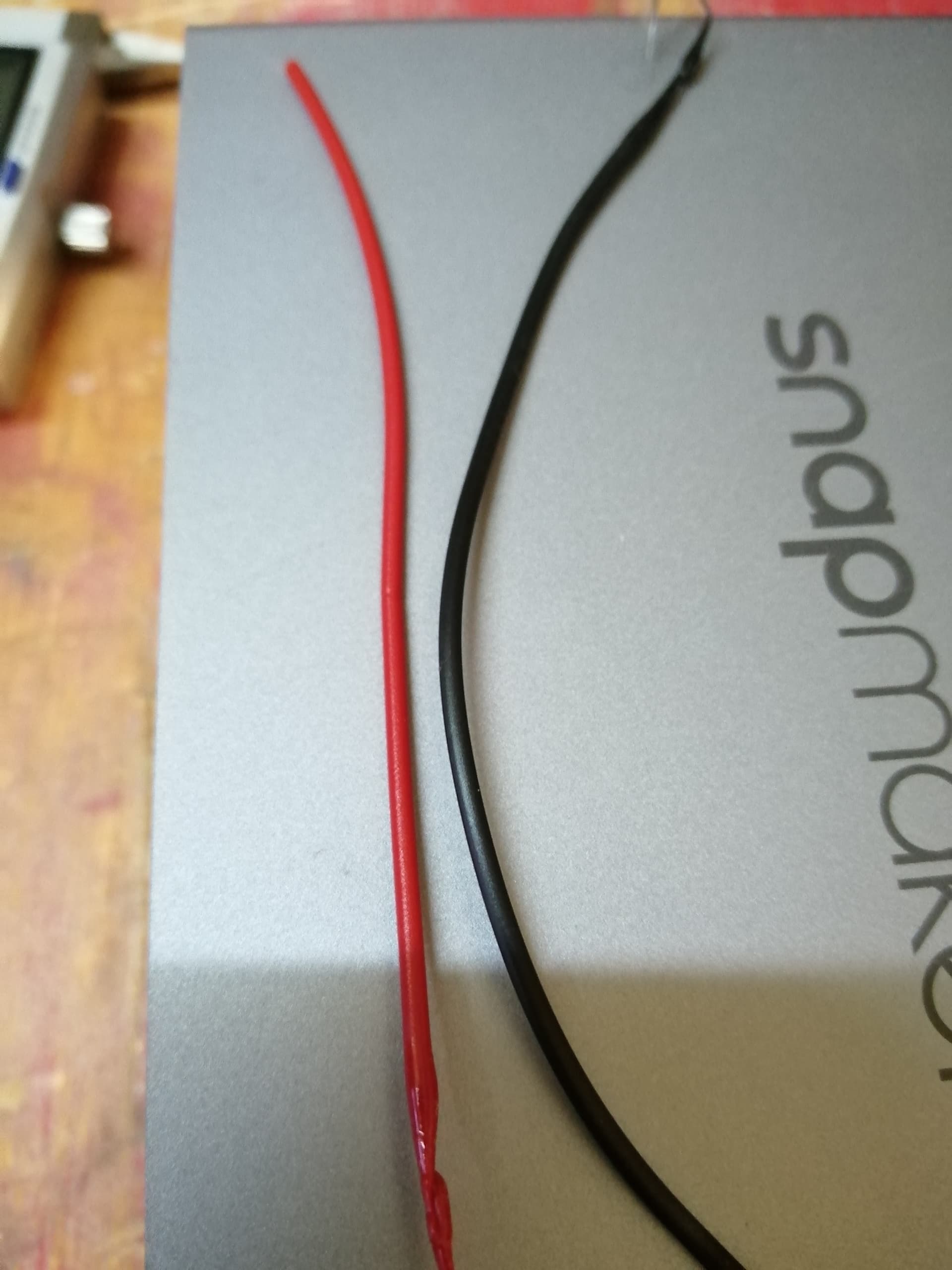

Then, I printed a temperature tower, which came out like this:
I didn’t really see much difference between the temperatures initially, so stuck with 210º (the spec sheet recommends 210º ± 20º). But, then I noticed that it gets a lot glossier the hotter it was, and that down at 190º it is more semi matt, like the original Snapmaker filament was.
This is a sample of both filaments, and the tower against the roll:
So, I’m now thinking I should only be printing at 190º. Would that be right?

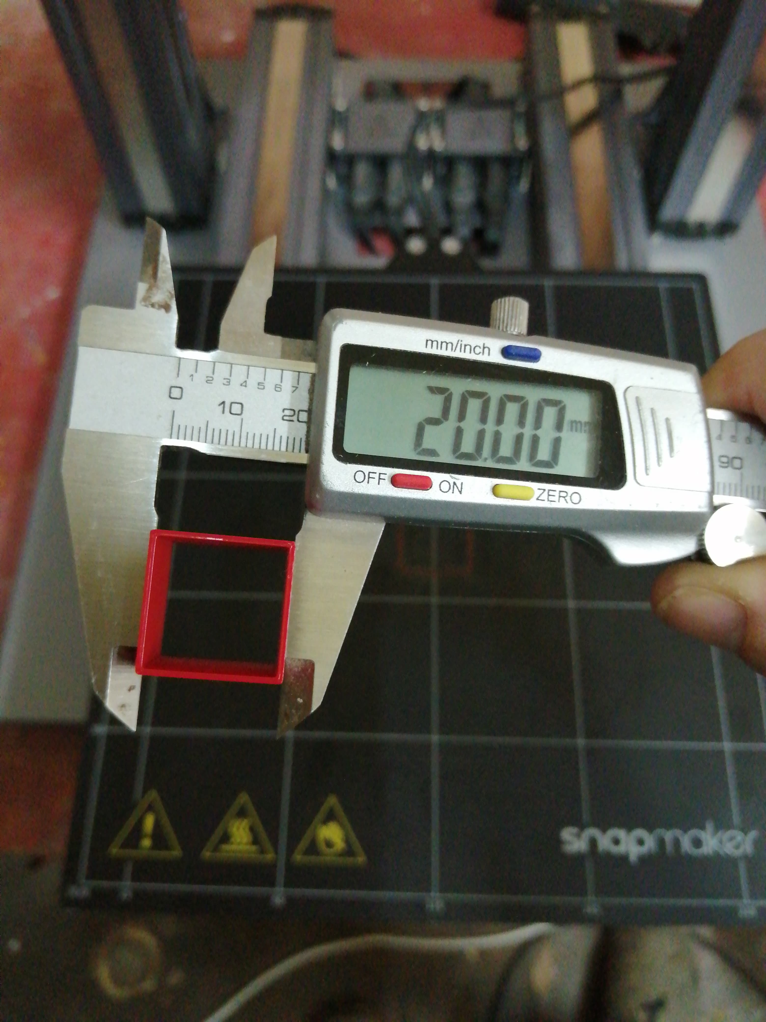

Then, I moved onto printing a small flow test cube to check the wall thickness. This was 2 walls at 0.4mm each, and at 100% flow the walls were coming out around 0.95mm (instead of 0.8mm). A couple of different rates were tried and at 90% flow rate, I got pretty damn close:
OK, actually, perfect! But, that was at 210º, so I guess if I do switch down to 190º then I should recheck this as I guess the flow rate will be different at a different temperature?
Next question is, is it normal for the first layer to be much wider? I always seem to get quite a noticeable lip on the bottom of a print, as you can see by the thickness of the bottom of the above cube:
It’s nearly twice the thickness of the rest of the print. Is that normal, or should I look at changing some first layer settings?

Being able to change the finish of your part from matte to semi-gloss is kind of cool. That can be handy depending on what you want the finish to look like.
I’ve run another, lower temperature tower, and I think that confirms my suspicion about it being too hot. This time there is a clearer difference (it wouldn’t even print the last 170° section) where there is a range around 185-190 that comes out matt. Weirdly it starts going glossy again when it gets cooler too?!

But now something else has cropped up. On every one of the little cubes I’ve done, the right side wall (closest to the touch screen) has printed the two walls right together which with the new settings measure near enough 0.8mm. The other three walls have a visible gap between them. I can squeeze them together with the calipers and they still measure near enough the same, but why would this one side always print differently?
… I’m confused too. That looks like left, upper, and lower walls are thicker than the right wall. Like an inner and outer shell were deliberately created. You said the gapped walls measure 0.8mm when you squish them together? What do they measure when you don’t force the gap closed? Does the original print have differing thicknesses like that too?
It’s a bit hard to measure them accurately without squashing them, but if say they are close to 1mm.
By original print, do you mean the model dimensions on the computer, or the first one I printed at full flow rate?
The full flow rate one is the same, just less noticeable with the thicker walls. I’ll double check the model when I get back to the computer later, but it was just one I got from thingiverse and put straight into cura.
The outer dimensions are slightly different to, presumably because of this. There’s some sort of xyz calibration you do as well isn’t there? Maybe I should do that too?
OK, I’ve just checked the model file. In Fusion, it’s hard to tell exactly, as for some reason it open it 10x the size it actually is. So, I’ve drawn up my own version, making sure the walls are 0.8mm thick and the outer dimensions are all 20mm.
Comparing the previews in Cura, you can definitely see a difference, so maybe the original model file I had wasn’t quite right. I did notice the gap before in this preview, but just assumed it was how cura was showing the lines. But you can see the new model, the walls are much closer together.
This was the original file:
And this is my new file:
So, I’ll try reprinting some of these new ones next and see how they come out.
Well, I guess this proves you can’t trust anything you find online!
First print of my own cube came out near perfect. There’s still a small difference between the x and y outer dimensions (it’s a bit short across the x face) , but the four walls are much closer.
Only slightly odd thing now is that the front x wall is a few hundredths thicker than the other three!
