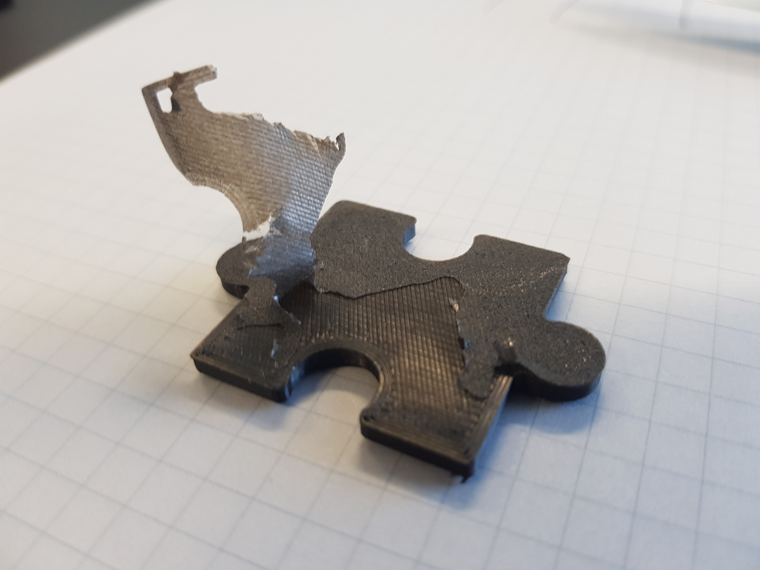

I have a problem with the delamination of the 1st layer and can’t determine the reason why.
The material is black PET but I have the same Problems with other colours but with the black one it’s the worst.

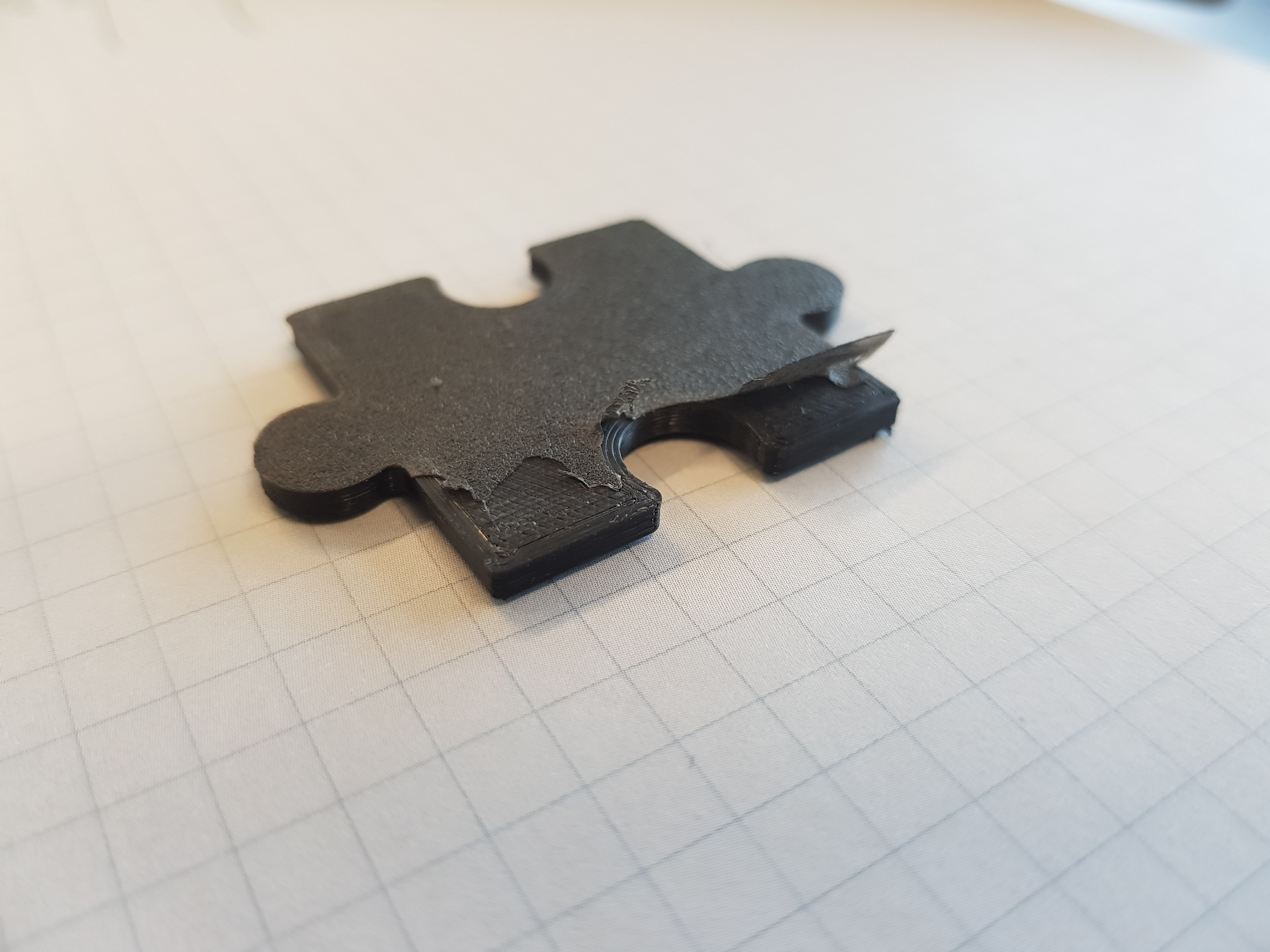

Here you can see the difference betwen the original surface and what’s left behind after you pull off the 1st layer:
A very homogene surface on the left and on the next layer you can see the single lines…
I’ve changed the platform sticker to a new one (very good idea!) and the print sticks very well to it.
  • General Speed: 30 mm/s (1st layer Speed 10 mm/s), outer lines at 18mm/s (9 mm/s for 1st), infill at 22,5 mm/s (11,25 at 1st).
  • Printig temperature: 220°C (range for the Filament: 195-220°C)
  • Heated bed at 60°C
Can you make a Suggestion what I should try to Change to clean out this Problem?

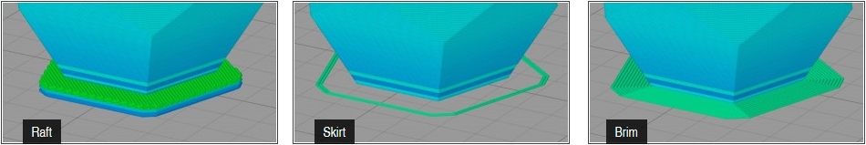

Are you sure thats not part of the support? Is it possible its making a raft then printing on it? just a thought, try turning off all supports.
This is definitely not a part of any support - because I’m printing without (flat and not too small puzzle parts like shown in the Pictures don’t require any)…
In my first days of 3D-printing I did use the raft a lot (because of the very small parts I wanted to print) but This Problem is a single bottom layer (very thin and not nearly as thick as a raft).
The Initial layer was my problem for the last week and I’ve tried many things becaue the print won’t start (needed a few tries to get the plastic laying down). So i set down the speed to get a good base layer for the rest of the model.
After the replacement of the platform sticker (I removed the glue remains with a rubber eraser which worked pretty good) it works just fine again.
It seems to be that it is caused by the slow speed of the first layer but I’ll be watching it the next few days/prints. The layer gets narrower and very smooth so the following layer won’t stick enough to the bottom layer.
The print I made yesterday was way better than the last ones. I doubled up the speed for the 1st layer and gave it an extra 33% in height (0,2 instead of 0,15 mm).

It looks like you have a single layer at 100% infill then go straight into a reduced infill. Try doing 2 or 3 full shell layers on the bottom. Or is it possible your bed is too sticky and the delamination is because there is better adhesion to the bed then the next layer in your model.
This was at 5 layers solid infill - bottom and top…
I achieved better results by overfilling the first layer by about 20-25% with higher temperature (box sais 195-220°C but I’m printing at 235/228°C for first/rest of the layers) and keeping the speed down for the first 3 layers.

Never had these problems again with PET-G. This delamination happens when the printing temperature is too low.
The “sweet spot” for my PET-G filaments on the snapmaker is about 245 °C (NOT the same settings like PLA!!! - and not 190-220°C like on the box from the reseller).
