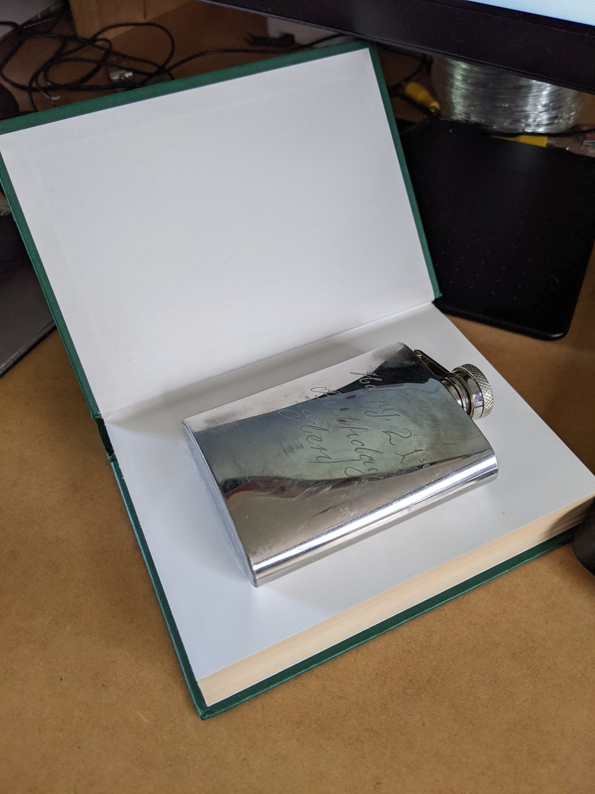

I’d like to “Shawshank” a book to conceal a hip flask. I figured a laser would be a neat way to cut the precise shape to fit the flask.

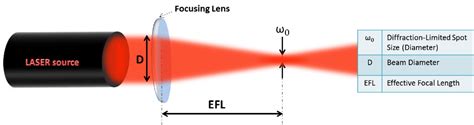

I think you’re looking at this wrong. There is not a specific cutting depth with the laser. It’s a beam that has a particular focus point (beam waist) wear the beam is narrowest and the power is most concentrated and the cutting is optimal.
iu
As it gets wider it loses power and preciseness. So depending on the material it still may cut or just char (or possibly ignite the material and set it on fire).
What I would do is figure out how many pages you can cut through cleanly (with however many passes) and then use something as a shield for the pages below it. A piece of thin plywood would probably work just fine.

If I want to cut at the focal point I need to lower the laser the deeper I go and therefore, theoretically I would have to pause the cut, fold back some pages and recommence. In this same scenario I assume I would only be able to cut as deep as the distance between the hood and the paper before having to fold back pages and start again.
However, as I alluded to and as you have stated above, as I cut away paper and the distance between the laser and the material extends, the beam will widen… but will likely still cut… but may start a fire.
I can’t find anything online suggesting anyone else has tried this so I was planning to just set it up and see what happens. I can always pause and inspect at any point if something doesn’t look right.
