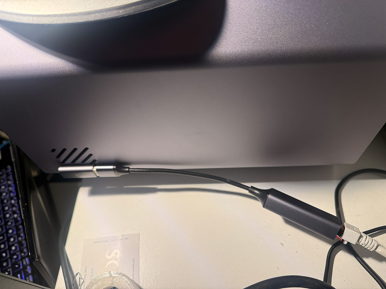

This thread about connecting the 2.0 via LAN motivated me to find out if and how this works for the Artisan because I’m presently building a segmented network for my production machines to be in a separate VLAN.
I used these parts:
Since the Snapmaker printers and especially the Artisan are designed products, I picked bits that looked like they somewhat match the color / surface / design and I’m quite fond of these. And even the better, they work!

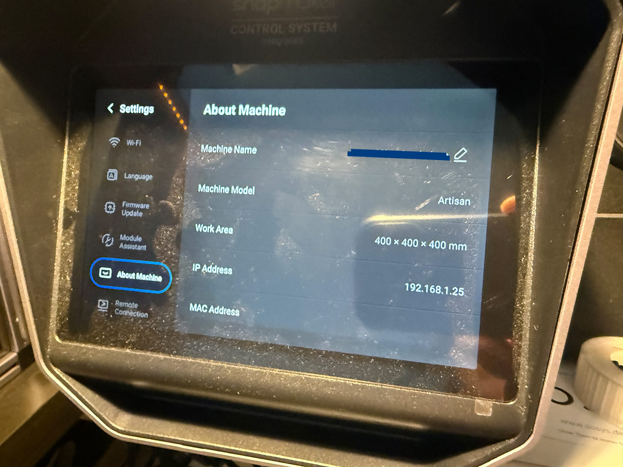

What I did on the Artisan simply was to hook this up to the side USB-A, start the machine and disable WiFi. The LAN adaptor works like a charm and provides a 1Gbit/s connection and draws an IP adress. Upon turning the Artisan on, it showed a short bit of traffic, so that looked good. I proceeded to give it a static IP via external DHCP to make connecting easier.
Now, as it was described for the Snapmaker 2, you can use it in Luban by manually entering the IP adress and connecting to the printer (Which is a setting Luban won’t remember the next startup).
You can also use the USB-A Port on the rear of the Artisan, doing so will however result in a maximum Speed of 100 Mbit/s (I didn’t conduct further testing beyond checking an established connection due to the slow speed). With the side usb, everything seems to work the way it is supposed to.
