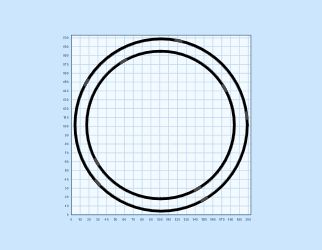

Made the dimensional file, of diameters and thickness.
Used Easel’s function to export to a .ZIP, which, after being exported as a zip, then unzipped, is supposed to, and seems to, include an .SVG version of the design.
So then I open Luban. I bring the .SVG into Luban.
The 2d depiction of the part that I drew in Easel (with a 7mm thickness) shows up on the screen in Luban.
I set the work dimensions and try to generate gcode but I end up dead-ended. I pick “vector” and then try to go to “Generate G code and Preview” but the “Generate G code and Preview” is greyed out, and, when I hover he cursor over it, it shows a circle with a slash through it.

Where I am dead-ended is that Easel doesn’t seem to have the option to choose Snapmaker as a machine, or to export a design in a file that I can bring into Snapmaker’s Luban- I tried getting an SVG out of Easel via the download of a .zip out of Easel, and Luban gets as far as showing a 2d depiction of my design from out of Easel, but then Luban won’t let me generate Gcode from it

I’d gladly settle for either Luban somehow ingesting my SVG from Easel in a way that Luban would then itself (Luban) generate the gcode. I can’t understand how Luban is managing to see and show my SVG and its dimensions, as designed, in Easel, but Luban won’t proceed to generate the gcode
If anyone, who is further up the learning curve than I am, is willing to please take a look at my .SVG from out of Easel, to see if it has any defects that would cause Luban to “grey out” and block the step at which I would generate gcode
(by the way, the image and dimensions show correctly in Luban, it’s just that Luban grays out and blocks the step at which I would generate gcode)
It really doesn’t get much more simple than Easel. You should be able to do the pro trial for a week or more.
There are some strange things that sometimes happen to svg files when imported to Luban. Like sometimes you need to convert text to paths. And you need to save as a simple svg. Not sure how easel saves svgs. You can create svg files more easily in any graphics program that supports vector. Inkscape is free.
