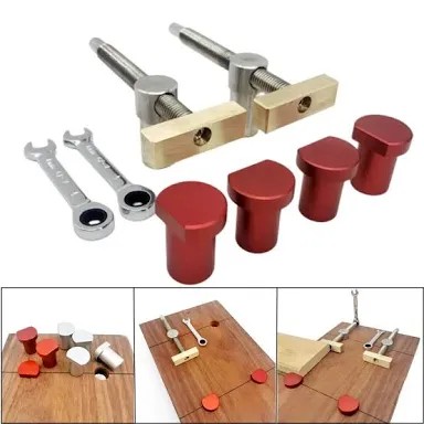

I think the most users here are not using the clamps. For me, i created a plate with a hole pattern and using stuff for a workbench like bench dogs. Like this here:
Holding from the top is not usable in most CNC jobs without wasting lot of wood for “clamps space”.
