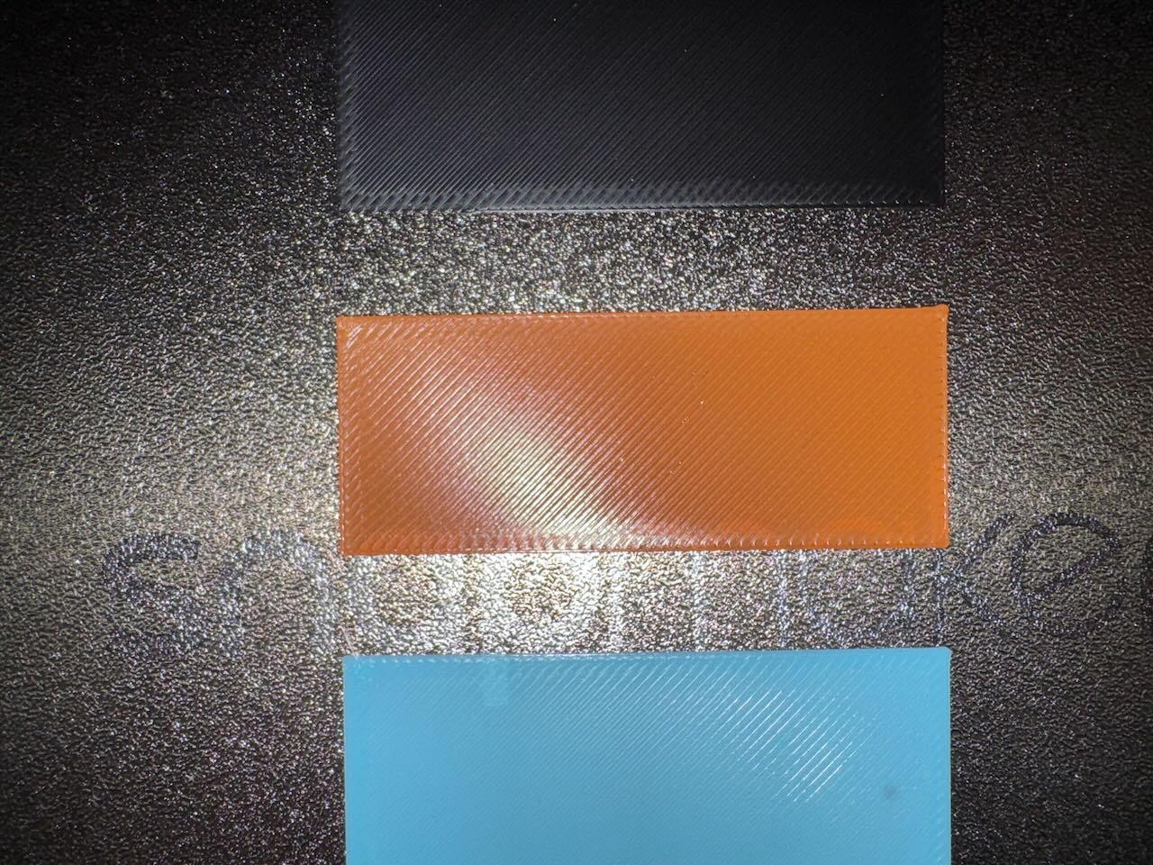

I was having issues with a good first layer and so manually calibrated the bed level, did a heated bed level and then did a toolhead offset calibration and got fantastic first layer now.
HOWEVER, this only seems to be working on toolhead 1. Switching to toolhead 2/3/4 gives me absolutely horrendous first layers and when I did the flow calibration it made it even worse and toolhead 2/3/4 are almost unusable in terms of the quality. I’m guessing it’s making some sort of flow adjustment inappropriately. I swapped filament between toolhead 1 and 2 and toolhead 1 regardless of the filament works fine so it isn’t the filament itself.
It’s possible this is a weird firmware 1.1 issue because calibrations and settings even when using flow calibration were decent before. My only issue was the edge of the bed plate which is why I did the manual z calibration to correct it and it did. This is the first full calibration I’ve done with the new firmware. (FYI the machine has been turned off and on since updating.)
What are my options or should I just do a full factory reset and start over?
See attached photos and keep in mind they were better prior to flow calibration but still bad. (brown is toolhead 1, black=2, darker blue = 3, light blue = 4) (unfortunately I didn’t realize the light blue photo was blurry until removing from the plate)

This interface looks familiar from my Prusa MK3S. I had a similar issue when the nozzle was too close to the print bed.

But looking at this print image, the overlap of the infill with the contour is standard at 25%. Your infill lines are covering the contour almost 100%. I really think the nozzle is too close to the print bed.
Nozzle too close is what I’m thinking because it isn’t the filament or the filament settings because swapping filament between toolheads, the issue stays with the toolhead not the filament. My only explanation really is a bad toolhead calibration. After resetting the filament extrusion flow calibration by removing and reinserting the filament it got slightly better but still is bad on toolheads 2/3/4.
FYI - I have done the flow calibration within SnOrca and got the settings that worked perfectly up until earlier today which is when things went bad. Plus, the fact that toolhead 2/3/4 is the issue seems to point to toolhead offset too because I’m surmising the toolheads 2/3/4 are calibrated as offsets to toolhead 1 so toolhead 1 working if it is say the ZERO point would be about right.

I guess it is worth noting that if you do a tool offset calibration you need to check the results before assuming it is right.
I did the calibration AGAIN and it solved all the problems. Very odd but I’ll take it as it appears to be fixed. Worth noting that I did NOT do an Extrusion Flow Rate calibration and am using the flow rate settings I arrived at with the Flow Rate YOLO test in SnOrca. I think these first layers look really good now.
