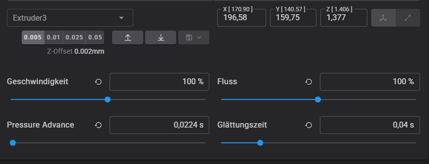

In Fluidd, you can monitor during printing which value is currently being used. Pressure Advance updates automatically when switching extruders.

In the fluidd console, you can track the results of the extrusion flow calibration.
During printing, these values should also appear in the overview under pressure advance. These are almost always multi-digit numbers. If only “smooth” numbers like 0.02 appear, they likely come from the slicer. I’ve tested this multiple times yesterday.

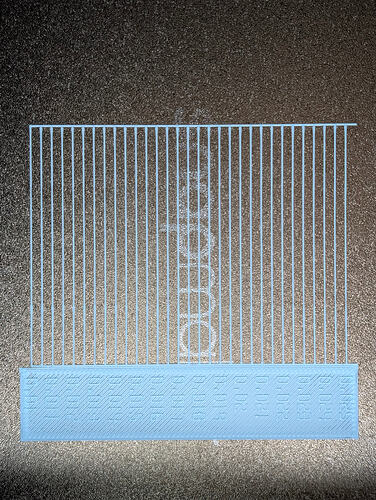

I’m not sure if I’m the only one with this problem, but the PA generated by the dynamic flow is grossly off. I usually use the built-in PA line calibration to determine the k value. When i use dynamic flow calibration, the k value returned is grossly different from what my manual calibration values are.
I’ll try that too!
I just posted the same sentiment in another thread, literally right before finding your posting. Do you know what’s measured? Why it would be that much off?

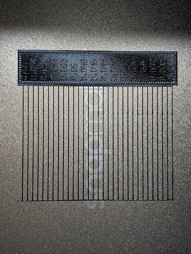

I also conducted a test yesterday with PLA matte. According to the automatic extrusion calibration, it was 0.0169. A manual calibration yielded approximately 0.0175–0.018. I find this value well-chosen. I will repeat this test again with Material4Print PETG deep black.
However, your value deviates significantly—I agree with you on that!
I have now tested the PETG. The automatic calibration resulted in a value of 0.033. Based on the test from the Orca slicer, I would set an optimal value of 0.051.
Do we know how the U1 is calculating this? I know my X1C uses Lidar but I don’t believe the U1 has Lidar.
Agree with you. If I only do a cornering test, that suggests using maybe a 25% higher value. Other tests agree very closely with the U1 though and resulted in slightly better top surfaces.

I have noticed that the automatic value differs from the value I determined with Tower. The print result is better with my self-determined value.
