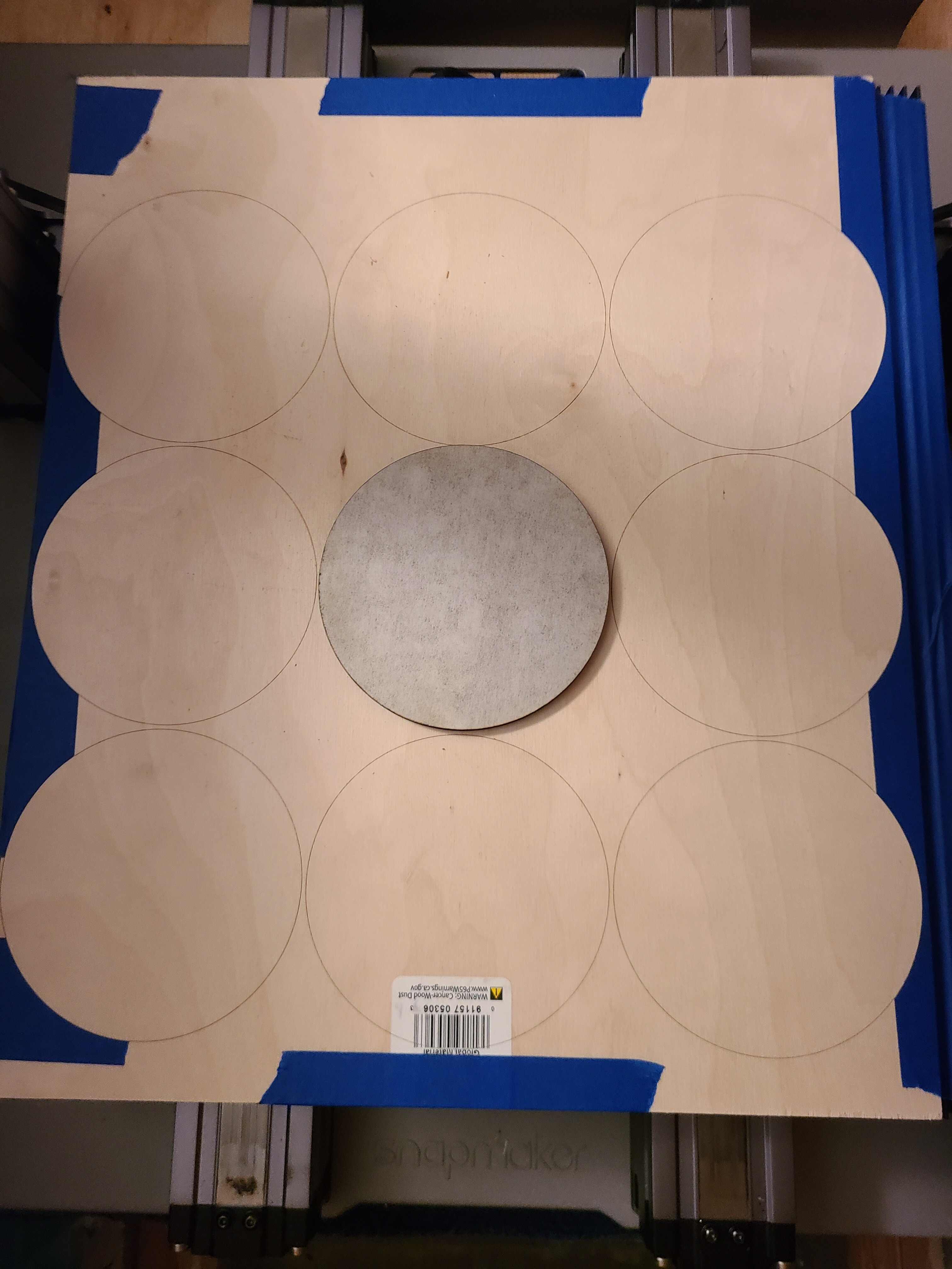

I am trying to consistently laser burn onto a set of coasters. To facilitate this I arranged 9 circles in Luban (just shy of 4 inch diameters) and burned those circles into a piece of wood I’ve taped to the platform.
This has allowed me to reliably place coaster blanks in the correct spot so I can be sure the laser burns to the proper coordinates.
However now I can’t open the Luban save file of the 9 circles to place my images at the correct coordinates in Luban (I previously was only testing in the middle circle and deleted everything but the middle circle content while I played with settings).
Every time I try to open the file Luban will open (separate instances if I keep opening the file) but nothing populates in the laser editor. I don’t think I’ll be able to place a new grid exactly where my old grid was now that I’m ready to start burning 9 at a time.

Ultimately what I ended up doing was re-doing my circles instead of trying to figure out going from my A350 back to Luban and this was for the best.
Instead of randomly dragging duplicate circles as I did the first time, I used specific XY coordinates and made a handy guide as well.
This way if I ever need to add a circle back in to Luban (but don’t want to burn them too), I can position it quickly, add in my content, then delete the circle.
I burned these circles into 3.2 mm wood that is taped to my platform. This makes it easy to place the coaster blanks (which are approx 3.88 inches or 98.6 mm in diameter) in exactly the correct position with a little blue painters tape.
Since my current project entails burning between 30-40 of these, I should have no trouble replicating perfect burns on the coasters every time now.
