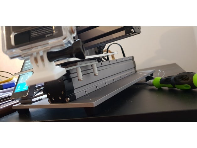

Hello,
I’d like to have a static view of the prints, i.e get the camera to follow the Y movement.
I am a bit strugging to find a way to fix it on the bed with a small arm.
Have you seen such examples please?
I reckon the front right corner would be the best.

The print sheet is magnetic. Make a fixture for your camera with magnets in its base.

All of the mounts that have been shared are nice but other than @eh9 they don’t actually answer the original poster’s question.
He’s asking for a mount that attaches to the bed so that the item being printed stays in position and therefore centered on the object being printed. When you do a time lapse with a camera mounted to the enclosure or the base, you get a lot of bed movement and the actual item is hard to see.
I was looking for one when I first got my SM, and the only one I found was this for the original:
I suggest using tinkercad to design one (or modify this one).
I still have plans to do so but just haven’t had a chance to do it.
