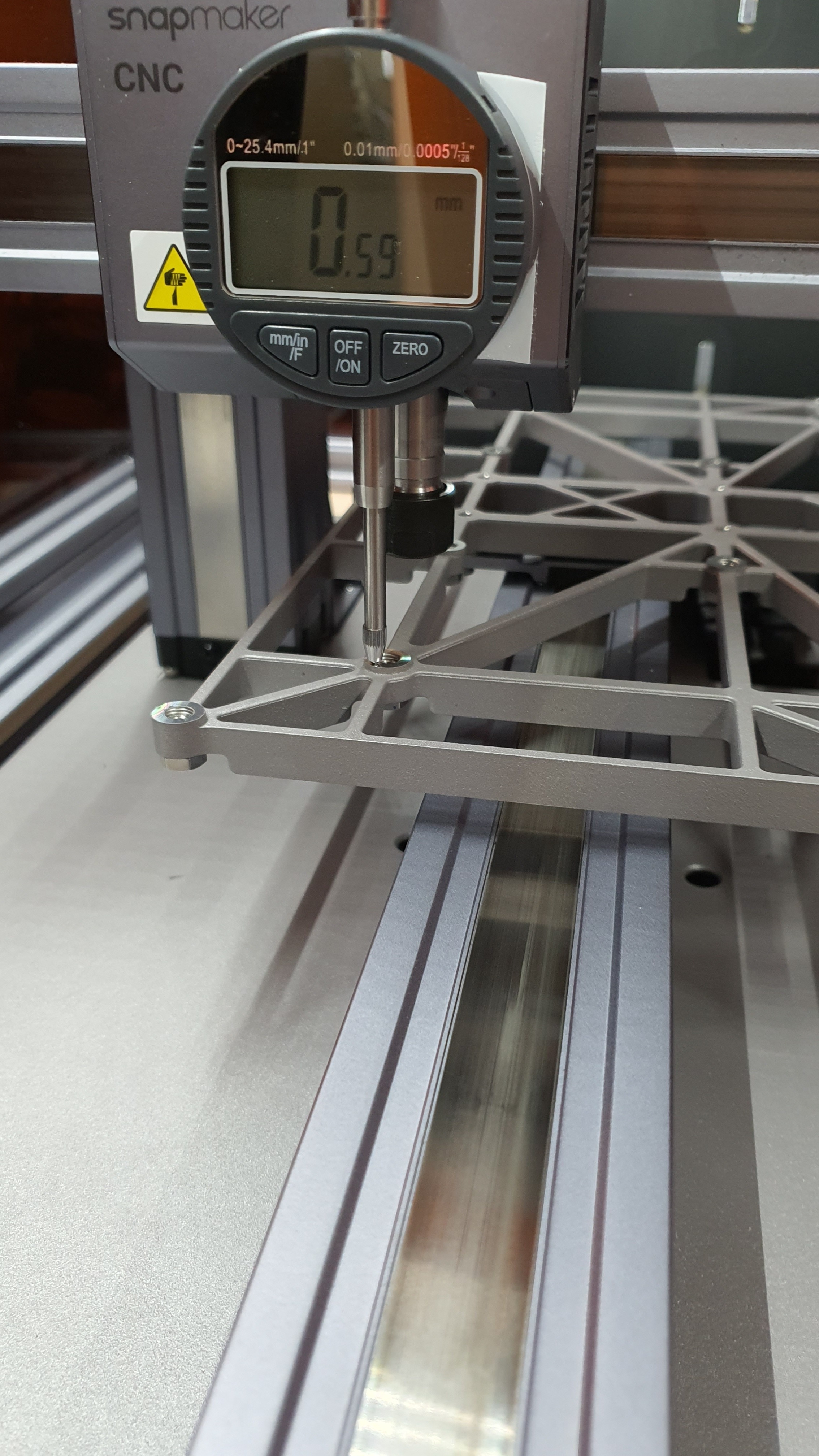

I had little problem 3D printing, I assume the auto levelling took up the issue. But CNC I found cutting a 2mm sheet of carbon fibre that it never cut through all the way in one side.
So I started to do some measuring. I fitted a digital depth guage to the head and started to measure the waste board. I had seen posts of people levelling by milling the waste board due to similar issues. Before I milled it flat I measured it and found it was almost even all round.
I took off the board and measured the four corners of the table on the top of the washers. See photo. The actual base plate is 0.77mm lower in one corner and 0.33 and 0.24… lower in the other two. It is the area of the 0.77mm that my carbon fibre never cut through, now I know why.
Any idea how I should proceed to fix this.
Thanks in advance.

@NeilL could you share how you measured to the top of the washers. I have tried to do this on mine and I am unhappy with my approach due to what i see as places for error to be introduced (like one can’t assume the base (the solid aluminum base) is flat for starters, is there some way to measure the platform (what you call base plate i think) without reference to the base but the x axis bar with the head or something more absolute flat than either?
I was placing a machinist square on the base and measuring up to the washers, but i found the deviation between washers didn’t match the sort of larger deviation i was seeing with M420 V.
Any tips you can share will be gratefully received.
My approach was reference with 123 blocks inserted between the bottom of the x axis and top of the y axis modules. Measurements taken with a dial indicator screwed on in place of a toolhead using a custom fixture.
thanks, i had my 123 blocks on the base, didn’t think about putting them on the y bars (doh)
did you then move the toolhead / platform with custom fixture and the platform by hand?
Moved with gcode. I used Excel to generate a gcode script, attached, for the older style platform. Obviously don’t run scripts you download from the internet blindly. You will need to tweak if you go that route, verifying each measurement location.

Here’s my setup:
Also, a PM is done (amongst other ways) like so:
Sure this was my process.
I removed whatever plate was on top.
I attached a digital depth guage (see pic) to the head, actually used some woodworking double sided tape.
Moved the head to home to ensure the Z was even
Jogged to the first measure point, top of washer, then zero’d the meter.
Lifted the meter rod with top lift button and jogged to next washer and lowered the head -have to lift the roof or it would get caught in the gaps).
See pics.

Well this took an interesting turn.
Support asked me to measure from the underside of the Y linear to the base of the printer, not the waste board or plate.
Oh wow, the difference in height is the same as to the distance of the plate.
I had to use a laser measure, but the accuracy is not to multiple decimal points as I had with the gauge, but every measure showed the gap between the underside of the Y to the base to be out by 1mm left to right.
So my thoughts now, and waiting for support to respond again, is that the two Z linear modules are different. When moving the head to the right the head goes uphill by 1mm from left to right. This is the same distance as to the plate.
I don’t know if there is a way to alter these or if the two linear modules will need to be replaced.
As I type this I realise I have one other measurement to take. From the top of the washer on the plate to the base of the machine, or to the top of the X linear. I am now thinking the wasteboard is actually flat but the difference in the two Z linear modules is causing the difference.
Off course there is no auto levelling with laser or CNC, maybe if they added that, the same as 3D printing the issue could be fixed in software? But will take forever to get written and tested.
Just to make sure. Did you tram your device (along the z-axis). Are the z-axes at 90degrees?
Tram? You mean follow the instructions in the build? Yes that was back in Feb.
90 degrees. I see what you are saying, but to be out enough to lift the head by 1mm would make it impossible to align the holes to attach the head. Plus the 3D print would not be square to the bed and create weird prints, which it does not.
I have placed a square on the base against the upright just in case, they look ok.
It is as if the homing is not aligning both sides to the same height, which suggests one of other of the linear modules is out by 1mm. But which one?
That is because the axis don’t align automatically. You have to do that manually.

I have read all of those but can’t find anything about how you are aligning. Are you saying using 123 blocks or similar and pushing the two to be the same height by hand?
How often do you do this?
Exactly. You push them down on the blocks. (or soup cans)
You must do this when the power is turned off.
I occasionally do it when switching toolheads. Just to make sure I didn’t unintentionally bump into them too hard. And I always do it after I had a little accident like bumping the toolhead in the platform or something like that.
An easier way is to pull it completely to the top. But that might not give as good results due to variations in the construction of the axis.
The important thing is you can do it in a repeatable manner.
