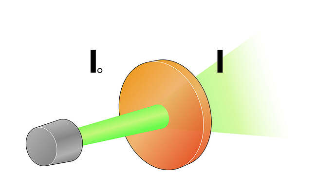

The general logic behind the OD rating is: The number behind OD tells you how many orders of magnitude the laser is reduced. So, with 40W you have:
OD1 → 1 order of magnitude less → 4W
OD2 → 2 orders of magnitude → 0.4W
OD6 → 6 orders of magnitude → 0.04 mW
AFAIK 1 mW laser power is considered safe even as a direct hit, as the eye lid reflex will be fast enough to close before permanent damage is done. I think if you want to be really scientifically correct, you’d need to take the beam diameter into account, but for the Snapmaker lasers the above should be OK. here’s a bit reading on that:
