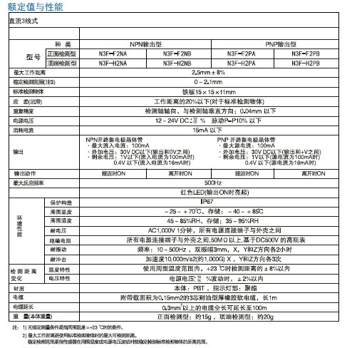

I found some details about that sensor on some Chinese site.
Baoler/BAOLSEN Proximity Switch N3F-H2NA
Sensing distance: 2.5mm
Response frequency: 500Hz
Voltage: 24V
Output type: NPN
Repeat accuracy: 0.04mm
Protection: IP67

The operating temperature (工作温度) is listed at 25 °C. I very much doubt the temperature at the position it operates in remains below 25 °C.
Anybody who’s had one of these fail because of temperature should make the claim that this is a designed-in defect and should be covered under a perpetual warranty.
Could the 25°C be the reason the bedleveling is done at roomtemp and not at operational temp as the sensor would ‘melt’?

The 25°C operation temperature is most likely not the operation temperature range. I would guess that this is more like -20…+70°C. It is probably safe to assume that the test and calibration conditions were 25°C (room temperature; a quite usual reference value) for which you will obtain the closest absolute results compared to the other values provided. For the bed leveling algorithm used by Snapmaker this is probably not really critical as you are left with the final, absolute positioning anyway. What you really need is good repeatability under the same environment conditions to get a good idea about the deformation of your print surface.
Perhaps, but I wouldn’t assume that. I double-checked that page again. There’s only one temperature listed anywhere on there, and it’s not a range. I couldn’t find a full spec sheet in PDF, either, which might have had a complete set of environmental parameters. Maybe such a sheet exists; maybe it doesn’t.
If the part were from the US, Europe, Japan, or elsewhere with a mature electronics industry that runs on specifications and parts expected to meet them, I might think a 70 °C operating ceiling could be expected, since that’s the conventional ceiling for non-milspec parts. But I’m not going to believe it without documentation on this part.

OK. Thanks. I’m not used at all to anything but PDF for data sheets. As an image, I can’t copy-paste those two characters before the -40 to 85 range into a translator; I can’t even make out the second character. Anybody know?
Given just how close that sensor is to the hot end, though, even 70 or 85 °C may not be high enough for long-term use.
You could use Google translator for Android and scan the image for translation.
I used a simple OCR translator:
The second temperature range is the storage temperature range. The numbers got a bit messed up…
