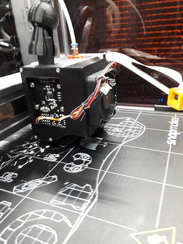

I crossbred your standoff with Atom’s mount, dunno if it’ll do anyone else any good, but I am about to mount the crossbreed on my snappy as I like your clearance and Atom’s mounting solution.
crossbreed.stl (562.8 KB)
Nice work but heavy to print

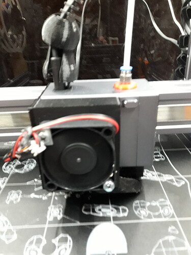

I still had 50mm CPU fans in the box.
Quick and dirty some changes to the files. Voltage reduced with resistance.
Seitenwand-links.stl (45.6 KB) 50mm-fan-box-trichter.stl (172.4 KB)

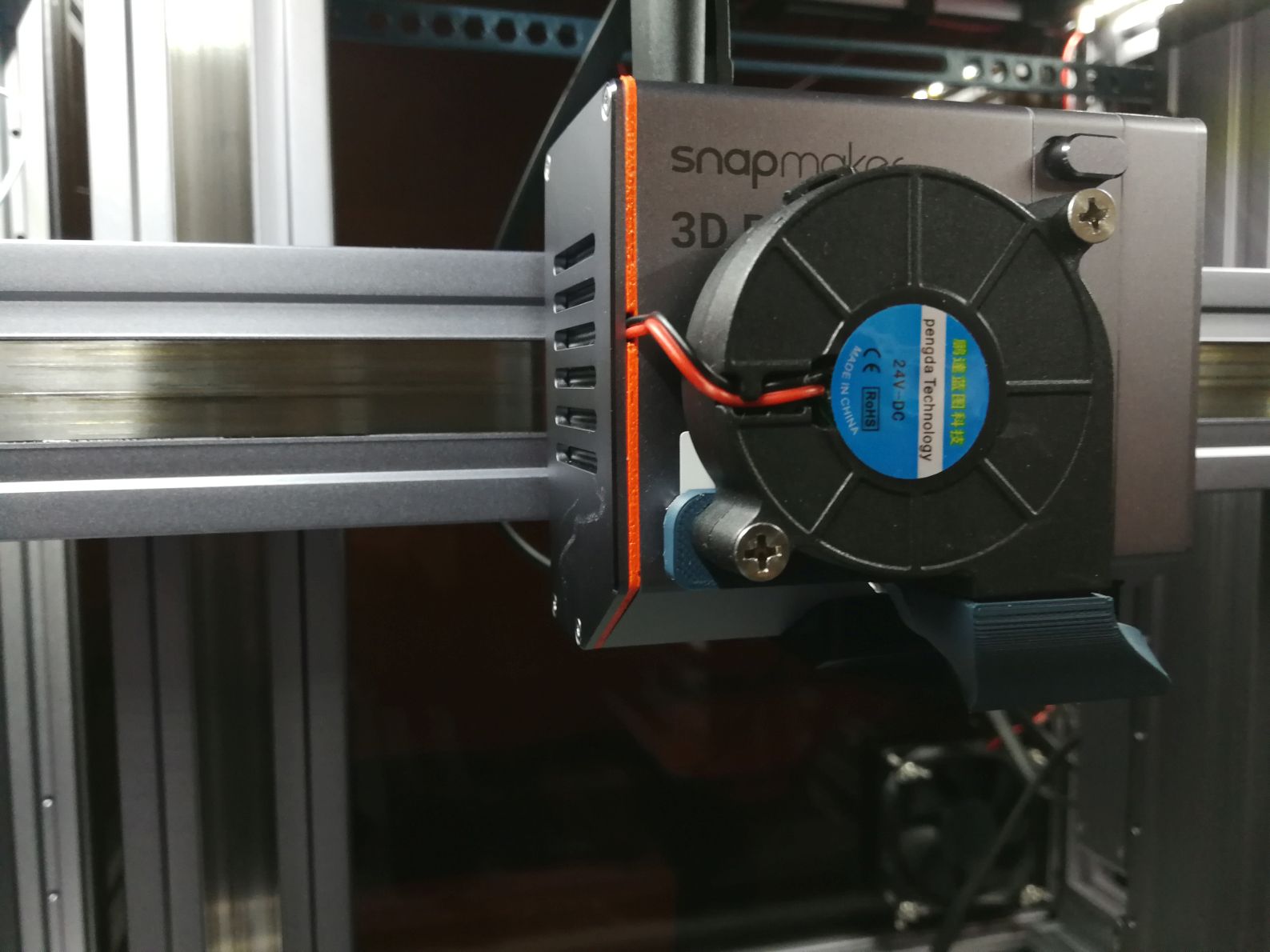

I finally managed to implement your mod on my SM2. At first it seems not to work and I was heavy on trouble shooting until I realized that the first layer gets no part cooling when is sliced by LUBAN.
Thank you for this great mod. Now bridging and stinging is much better.
Thanks to Atom as well. I cut his design to get the spacer plate for passing the cable. I got it to late C.Harris did it already.
But now I´ve got an other issue. I can´t regulate the speed of the fan. Using LUBAN it´s not possible to set the speed and even when I use Marlin codes in the console (e.g. M106 S128 for 50% running speed) it does not work.
I think the fan runs always on 100% what causes heavy warping now.

The M106 S128 should be working. Is it possible it’s on at 50% power, but it’s still just too much air? The command response is not linear, like many would want, unfortunately. What about M106 S0 or M106 S10, that should be basically off. I think I can run as low as M106 S20 or M106 S40 and still have it turn.

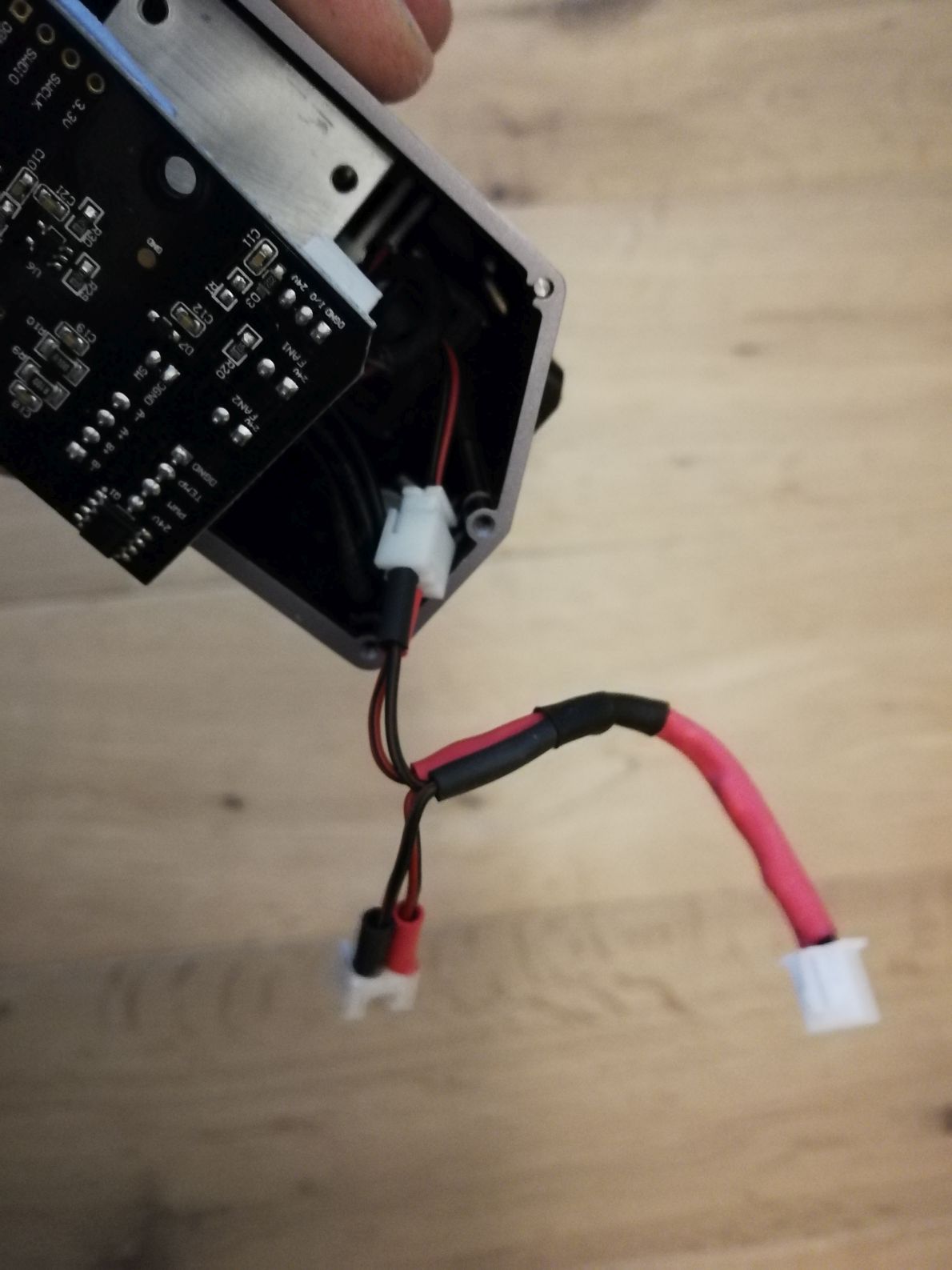

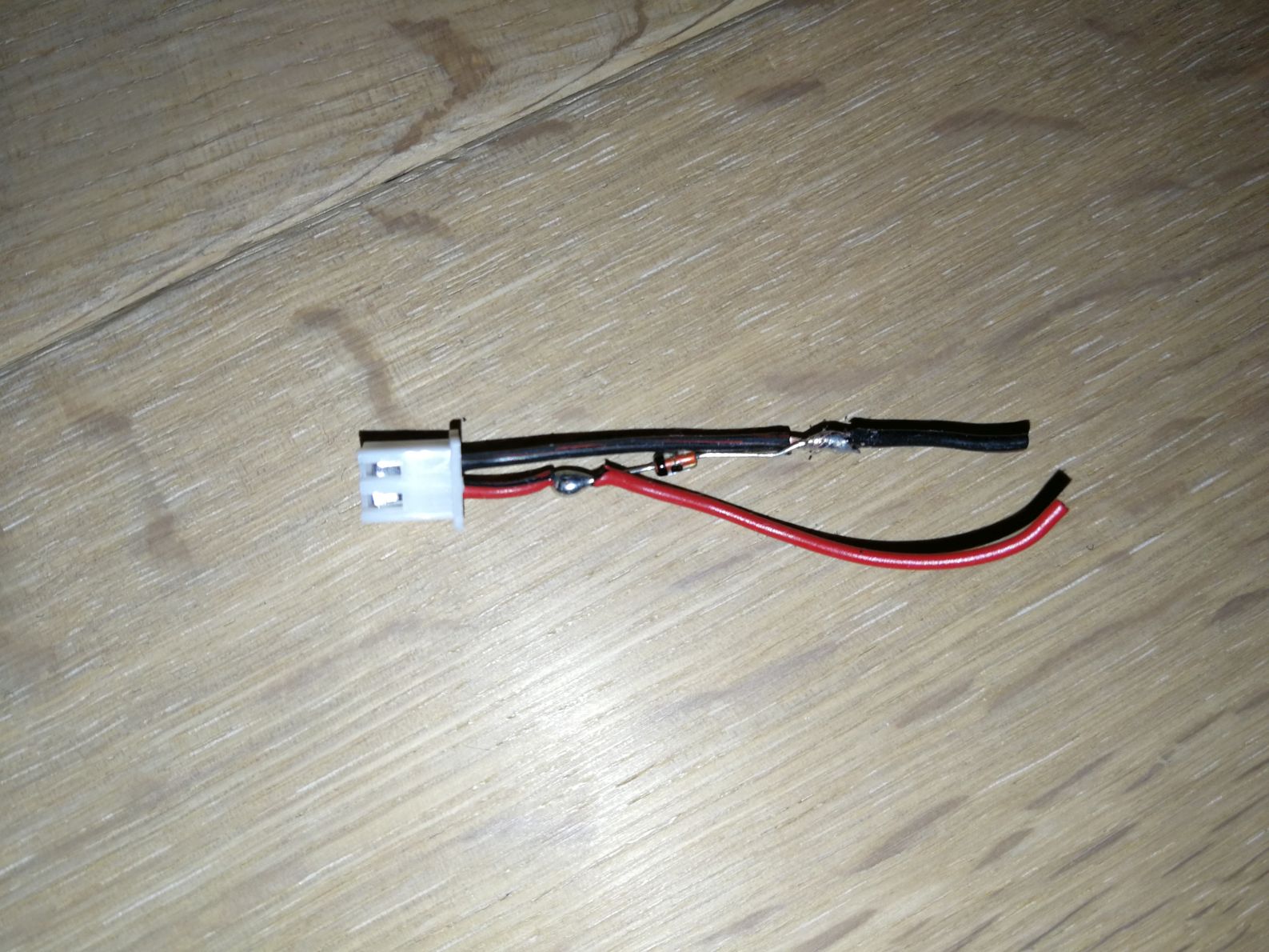

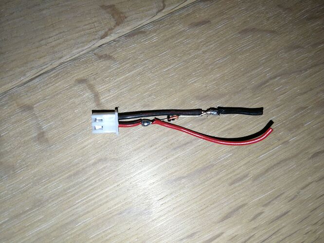

So to make sure I have this right before I attempt soldering my Y splitter, the fan in this diagram represents both fans wired in parallel, so both female red (powered) leads that the fans plug into are soldered to the single positive lead for the male connector that plugs into the board, and likewise for the black (ground) leads?
Then the diode is soldered so the line on the diode is on the end attached to all powered leads, and the opposite end is soldered to all ground leads? This way, residual power on the grounded side of the fans is allowed to pass back to the powered end, but not the other way around, right?
Sounds right, yes. Line to positive, otherwise it’s a direct short circuit. And yes, the fans are in parallel.
