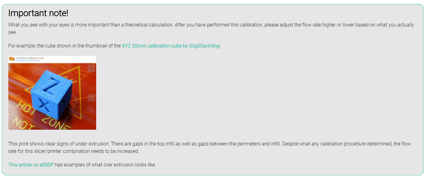

https://teachingtechyt.github.io/calibration.html#flow
However, be mindful of the note at the bottom, as this will probably cause more harm than good if your prints already looks pretty good.
