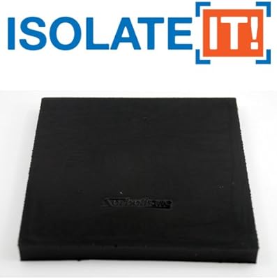

After some use I have realised that they are good at attenuating the lower frequency sounds but not the high frequency. I have seen that some people are using an elastic substance such as Sorbothane. When I get some time I might try that out too.
Indeed, but it still reduces the rattling quite a bit.
Sorbothane looks interesting as an idea, but it is fairly expensive by the looks of it
